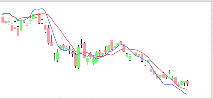

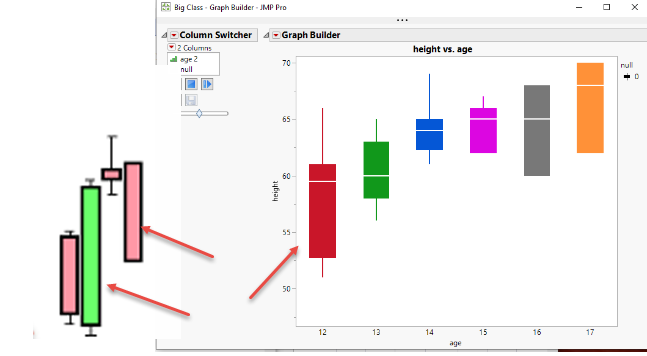

the data describing stock price movements is created by open/close price and max/min price. Is there any way to create box plot (candlestick chart) in JMP having real body from open and close price and upper and lower shadow having values in max (high) and min (low) prices respectively, like in the picture attached or is there better way to do that? The traditional Box Plot element, however, shows outlier or quantile box plots and provides a compact view of a distribution of values. I attached an example data table in which several timestamps and price values (min, open, close and high) are provided. I would appreciate for hints and suggestions.

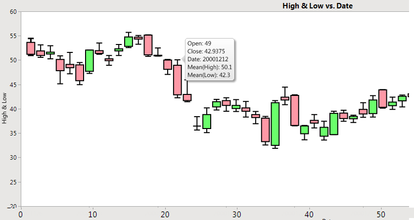

txnelson
Re: Presenting stock data in form of box plot
The columns that are displayed when you click on a data point, are columns that have the "Label" column property set.  In my original code, the open and close columns have their Label values set.  All you should have to do is to add a line for each of the columns you want to add the Label column property to.

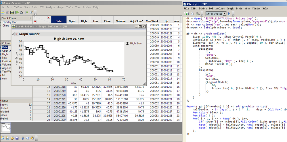

I tried not to use date-spec data, but ended up not modifying JSL.It didn't work.
As in JSL below, how to draw box diagram with new data?Thank you very much!

txnelson
When you changed from using column Date, which is a JMP date column(the number of seconds since January 1, 1904), to the column New, which is just an integer where each row is just 1 more than it's previous value, you needed to change the calculation of the variables, "days" and "halfDayincr".  The number of days is just the number of rows, and the halfDayincr, which is half the width of the rectangle to draw, is simply .4.

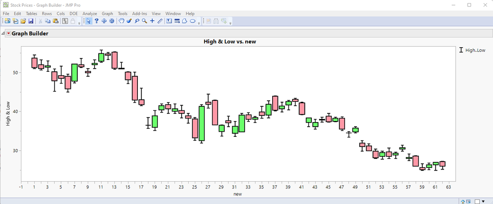

txnelson
Here is a modification that handles the elimination of the black outline

Concerning how to manually/interactively
  1. Drag the high and low columns to the Y axis drop area
  2. Drag the new column to the X axis drop area
  3.  Right click on the chart and select      Smoother=>Remove
  4. Right click on the chart and select       Points=>Change=>Bar
  5. Right click on the chart and select       Bar=>Bar Style=>Interval
  6. Drag the Direction column to the Color drop area
  7. In the legend, right click on the color box for Increasing and select        Fill Color=>select a light green color
  8. In the legend right click on the color box for decreasing and select         Fill Color=>select a light red color
  9. Now the boxes for each high and low need to be added.  This is done by adding a graphic script to Graph Builder
    1. Right click on the chart and select      Customize
    2. Click on the + box to add a new script
    3. In the script editor area, add the following script (the script is developed by the individual user.  In this case, I wrote the script)
      halfDayincr = 0.4;
      days = Col Max( :new ) - Col Min( :new );
      Pen Size( 1 );
      For( i = 1, i <= N Rows( dt ), i++,
      	If( :Open[i] <= :Close[i],
      		Pen Color( light green );
      		Fill Color( light green );
      		Pen Color( light red );
      		Fill Color( light red );
      	Rect(
      		:new[i] - halfDayincr,
      		Max( :Open[i], :Close[i] ),
      		:new[i] + halfDayincr,
      		Min( :Open[i], :Close[i] ),
      		1
      	Rect(
      		0
Click on OK
Jim
