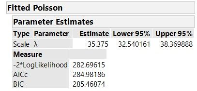

I have data that are count/space.
In my case, (number of events occured / time). As such, it is naturally I would fit these data using Discrete Fit > Poisson.
Afterwards, JMP produces the fitted Poisson with results of Upper/Lower 95% Confidence Interval per below photo.
My question is : How do I get Upper/Lower 95% Prediction Interval?
Thanks for the pointer.
B.r,
Chris

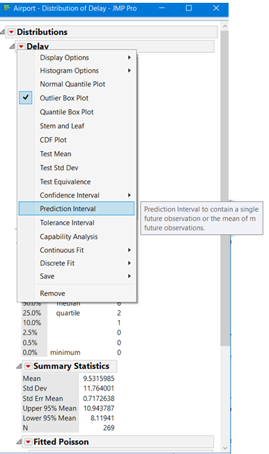

I don't know which version you are using. Check the inverted red triangle menu next to the variable outline box
Here is an example script:
Names Default To Here( 1 );
dt = Open( "$SAMPLE_DATA/Quality Control/Airport.jmp" );
obj = Distribution( Column( :Delay ) );
obj << Fit Distribution( Poisson );
obj << Prediction Interval(0.95, 1);

The reason I am questioning that is because, you can see the Confidence Interval calculated are two totally different value (based on 95%).
In my example:
Confidence Interval 95% caculated (based on t density function) is 22.6 to 48.1.
Confidence Interval 95% calculated (based on Poisson density function) is 32.5 to 38.4.
Due to this, it makes me wonder that the Prediction Interval option as you have shown will calculate based on the t density function rather than Poisson.
Hope this brings the question clearly now.
