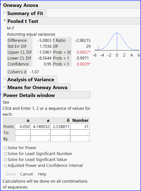

Using the Fitness dataset, plotting Oxy vs Sex, performing two sample t-test, p-value is low, at 0.0057. But now check the Power of this test.

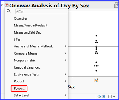

From the menu, if you select "Power", adds the "Power Details window" section to the Oneway  window:

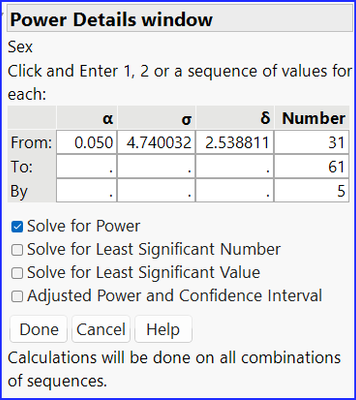

If you select "Solve for Power", it will give you the Power of this test.

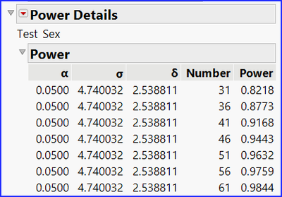

Also, you can do a "wait-if" on increasing the number of samples, by steps. Looks like this:
And there is a small power plot at the bottom!

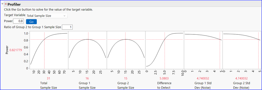

Recreating in the DOE > Sample Size Explorers > Power > Power for Two Independent Sample Means, get the same 0.8218 for Power.
