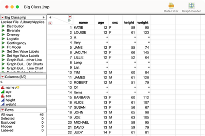

Thanks Vince.  I knew there was a way.  I like this method the most since I can tailor the code insert values to any row, even if they aren't contiguous:
Names Default To Here( 1 );
Try(Close("Big Class.jmp", NoSave));
dt << Add Rows( 2, After(2) );
dt << Add Rows( 2, After(7) );
dt << Add Rows( 2, After(12) );
dt[[3 4 8 9 13 14], "name"] = {"A", "Very", "Long", "List", "Of", "Items"};
