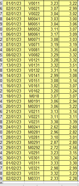

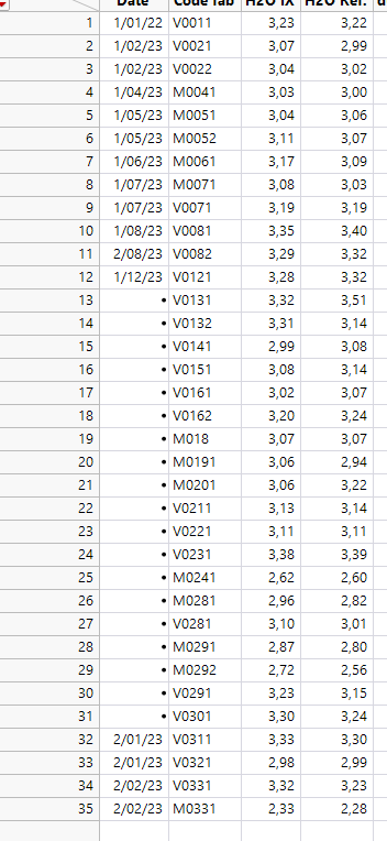

je n'arrive pas pas à importer les bonnes dates à partir d'un fichier excel.
j'ai mis au bon format la colonne date excel.
j'ai essayé plusieurs formats dates dans Jump.
Jump n'importe pas toutes les dates et pas au bon format.
en jaune: le fichier excel.
est-ce que quelqu'un a une solution?

Difficult to say without having the actual files. Perhaps you could put the Excel file here, but only with the first two columns? Also, how are you trying to get the data into JMP? Are you using the Excel wizard? That will allow you to try different things to ensure that you get the data to come in properly.
My best guess is that the format of the dates is causing issues. It looks like you have this as dd/mm/yy. However, the first 16 rows or so could easily be interpreted as mm/dd/yy format. JMP is likely picking up that and setting the rest of that column to that format. In JMP, try looking at the column properties for your date column. Make sure that the format and the Input format are both d/m/y. Perhaps that will solve the issue.

Hi Francoise,
It looks like the dates that do not fit the US date format (Month/Day/Year) are ignored because your input is in an international format (Day/Month/Year). As Dan suggested, I recommend using the Excel import wizard to help JMP figure out the date format.
Also, when I encounter similar problems, I import the dates as text and then change the column format to Numerical with an Input Format "dd/mm/yyyy" and an output format (Date) of your choosing.

problème résolu avec "Informat":
Column( dt, "Date" ) << Data Type( "Numeric", Informat( "d/m/y" ), Format( "d/m/y" ) ) <<
Modeling Type( "Continuous" );
