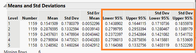

suI assume you wish to extract all of these for each of the Levels
I think this might be even faster (at least it is easier to script)

ow = dt << Oneway(
	Y(Eval(cont_cols)),
	X(:Site),
	Means and Std Dev(1),
	SendToReport(
		Dispatch(
			{"Means and Std Deviations"},
			"Std Dev Lower 95%",
			NumberColBox,
			{Visibility("Visible")}
		Dispatch(
			"Std Dev Upper 95%",
			NumberColBox,
	Invisible

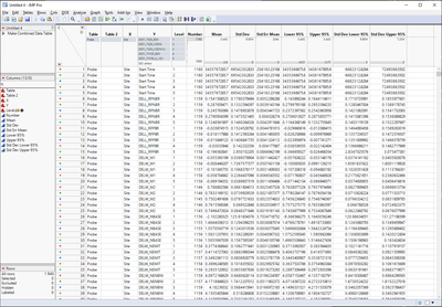

You can run Oneway for all of your columns at the same time WITH Means and Std Dev enabled (and "hidden" columns visible), get reference to first table box and then use << Make Combined Data Table. You will get result like this
You should then be able to use Update to add those columns you need to your final table.
If this doesn't work out for some reason, looping will and there are few options how you can do that. Use << Make Into Data Table and Update OR get the results from the table box into lists (<< Get might be enough) and update your data using lists + data table subscripting.
