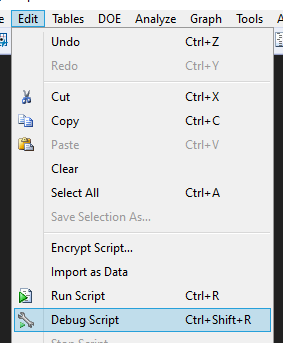

If JMP14 did have Debugger (and you can get that working as that might not be that easy) you could also try that
