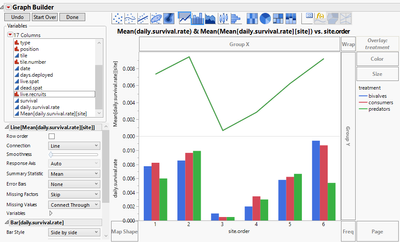

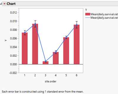

I am trying to create a single graph with two plots.  The first is a bar chart of survival across six sites, overlayed with a treatment replicated at each site.  The second is a line graph of the average survival at each site across treatment.  I can create exactly what I want in graph builder, except that I have to plot the line on a second graph above the bars (attached graph builder image).  And I can create exactly what I want with the chart platform, except that I cannot figure out how to overlay the treatment variable for the bars (chart image).  I feel like there has to be a fairly obvious way to achieve this that I am missing.

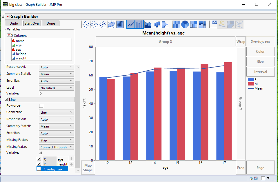

Here is how I did what I think you want
1. Drag the x (site_order) and y(daily.survival.rate) columns into the graph.
2. Drag the Treatment column to the overlay
3. Click on the graph and select
     Add==>Line
4. Two lines will appear.  One for each Overlay.  So what you need to do, is to go to the Properties Area on the left of the graph, and find the Properties for the Line.  Go to the Variables area and click on the gray triangle to open up the variables list.  Unclick the Overlay for the Treatment variable.
There will then only be one line.
I believe this does what you want?
Jim

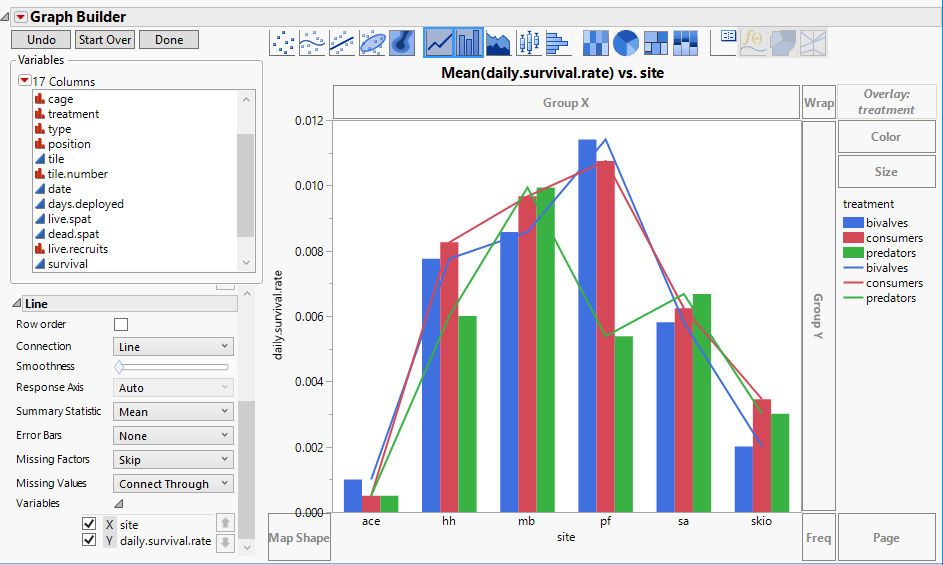

The image you included is exactly what I'm looking for.  I'm able to follow along with your instructions until the final point.  When I open the variables for the line, I don't see an option for the overlay.
Graph builder 2.PNGI'm working in JMP Pro 13, could that be an issue?

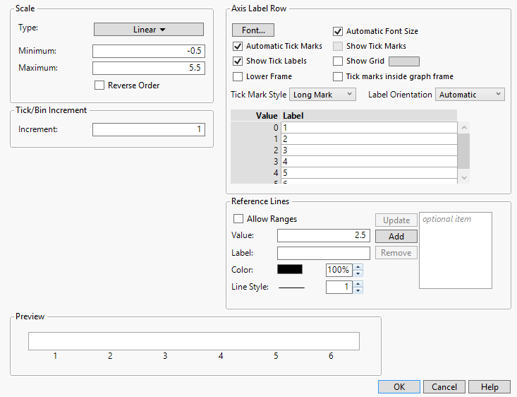

If you run the script, the chart, and the "add graphics script" will run.  If you are not getting a line drawn on the chart, I assume that there may be an issue with matching the x values for the line, with what the x values for the chart are.  Please go to the x axis on the chart, and right click on it and open the axis settings.  The assumption in my code, is that the x axis values have a minimum value of around zero, and the max a value about equal to the number groupings of your column :treatment.
If that is not the case, then reply back with the min and max axis values.
Jim

The values run from 0 to 5, so if I'm understanding you correctly, there shouldn't be an issue, correct?axis settings.PNG
