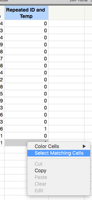

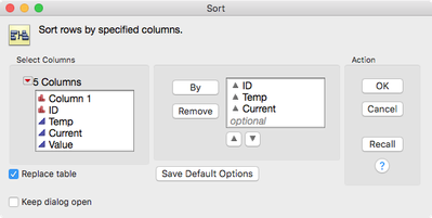

Start by sorting the data table by ID, Temp and Current.

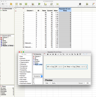

Then, you can create a new column that looks for repeated ID, Temp combinations and sets an indicator.
Now you can right click on one of the 1's in the new column and choose Select Matching Values. That will select all the rows that have a 1 in that column. Now you can Hide and Exclude the rows.

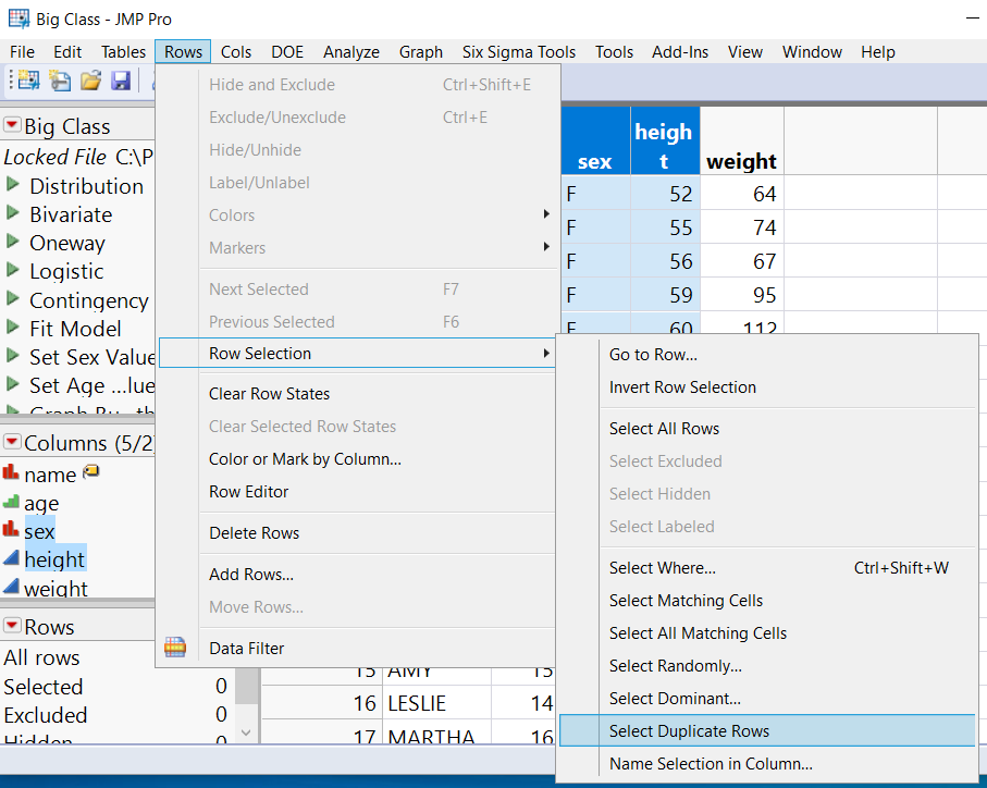

In JMP 14, you can use the new "Select Duplicate Rows" function interactively or in JSL.
For example, in Big Class to select the weights that are higher under the same sex and height. First sort the table ascending by sex, height, and weight.
Highlight the sex and height columns in the datatable. Go to Rows>Row Selection>Select Duplicate Rows. This will select the everything but the first instance of the same sex and height. You can then hide and exclude from there by going to Rows>Hide and Exclude.
You can also script these steps.

You can do this all interactively in the data table.
