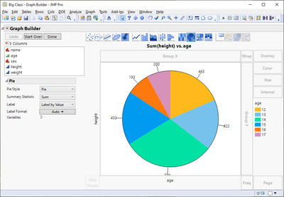

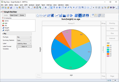

Too bad you cannot get rid of the pie chart (most overused and usually bad way to visualize anything). Below is script which might give some idea what you could do, the calculations definitely aren't optimal but they might work (I don't really remember unit circle and trigonometry anymore)
Names Default To Here(1);
ADJUSTED_LOCATION = 0.8 ; // default is 1
dt = open("$SAMPLE_DATA/Big Class.jmp");
gb = dt << Graph Builder(
	Variables(X(:age), Y(:height)),
	Elements(Pie(X, Y, Legend(2), Summary Statistic("Sum"), Label("Label by Value")))
fb = Report(gb)[FrameBox(1)];
pie = fb << Find Seg("Pie Seg");
{x_origo, y_origo} = pie << Get Origin;
radius = pie << Get Radius;
Summarize(dt, groups = By(:age), sums = Sum(:height)); // we must know summary statistic used in pie chart
r_sections = Reverse((sums / Sum(sums)) * 2 * Pi());
angles = {};
For Each({section, idx}, r_sections,
	angle = (section + Pi()) / 2;
	If(idx > 1,
		angle = angle + Sum(r_sections[1::idx - 1]);
	Insert Into(angles, angle);
label_locations = {};
For Each({angle, idx}, angles,
	i = N Items(angles) - idx;
	xcoord = x_origo + ADJUSTED_LOCATION * Cos(angle);
	ycoord = y_origo + ADJUSTED_LOCATION * Sin(angle);
	location = Eval List({i, xcoord, ycoord});
	Insert Into(label_locations, Eval List({location}));
For Each({location}, label_locations,
	Eval(EvalExpr(
		pie << Set Label Offset(Expr(location));
default
ADJUSTED_LOCATION = 1.1
This could be turned into a function which would be able to add lines to the labels.
