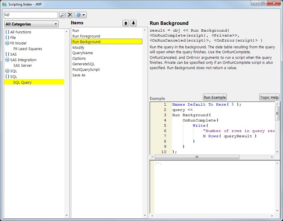

pmroz
Re: Parallel Processing in Scripting
I think starting with JMP 12 you have the ability to run SQL statements in the background.  Go to the scripting index and search for SQL.  The last search result is SQL Query.  One of the options is Run Background.
I have never looked at that. Thank you!
