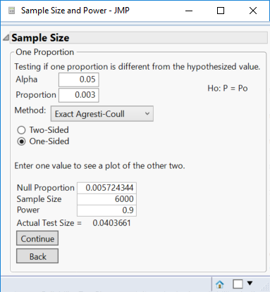

Here is the result:
This means that you have 90% of finding a change to 0.59% failures with this sample size. Changing the sample size to 6000, the null proportion decreases to 0.57%:

Here is the result:
