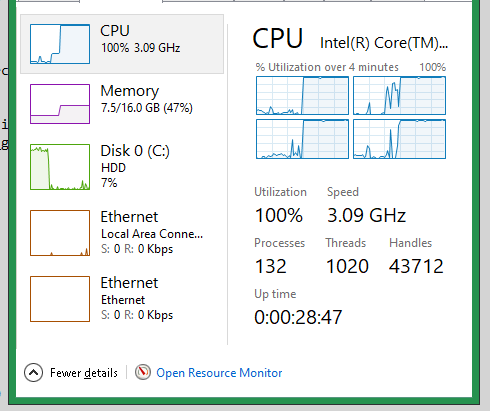

The parallel assign is copying a large matrix for each CPU, but the linear graphs don't suggest that to be a paging issue, at these sizes.
Watch the windows task monitor for CPU and Memory (and Disk) usage and see if it explains anything. I saw 100% during parallel assign and 25% during the sequential test. I also saw 7GB used during the bigger parallel assign.
task managertask manager

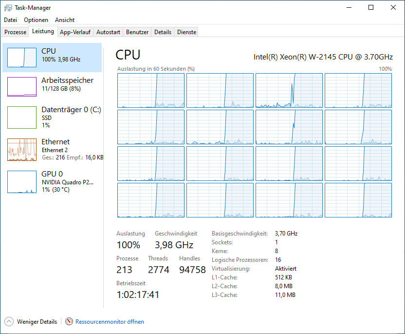

Hi Craige,
I'm just looking at my worst performing Workstation now (below). I did not see anything suspicious in the Task Manager. Except CPU, nothing is close to full occupation.
What I also noticed is that JMP 15.2.1 is always faster in the parallel and sequential versions. In the case of  n=100,000 JMP 16.1 takes around 36s/18s (parallel/sequential) and JMP 15.2.1 31s/15s which is a little better but still far away from good parallel performance. Unfortunately, I don't have an older version available any more. I wrote this code using JMP 12 and didn't notice performance issues back then (and the PCs I was using were different, too).
Rob

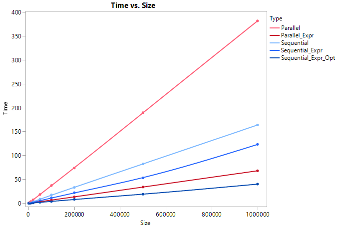

Oh, wow thanks! Running your script on my newer Workstation I get
Parallel: 37.0833333333139
Sequential: 19.7166666666453
Parallel_Expr: 6.93333333331975
Sequential_Expr: 12.5333333333256
Sequential_Expr_Opt: 4.54999999998836
Let us not regard the Sequential_Expr_Opt one because it's an unfair comparison. :)
You just replaced the function by an expression and I get a speedup of approximately 1.5 for the sequential and more than 5 (!!!) for the parallel version? That's a great workaround. So what do I learn from this? Never use functions in JSL? That's a bit unpleasant because functions make code more readable and easier and safer to use and modify for others. However, I think there is still a problem somewhere behind the scenes becuase my original parallel version still takes twice the time of the original sequential one and this is not the case on Craige's virtual machine.
Update: Here is the full scan on the new Workstation:
