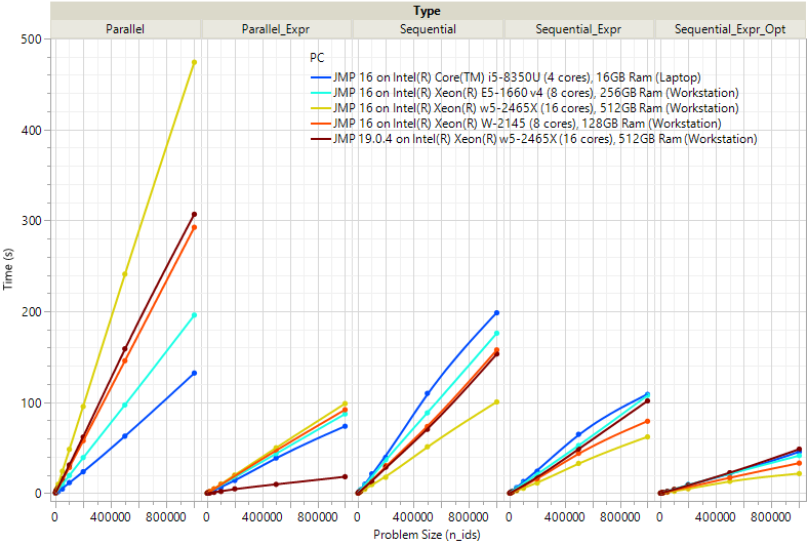

Hi everyone,
Great news! Now after 3 years I ran all 5 parallel benchmarks (thanks again @EvanMcCorkle ) again on one of the PCs that I already had at that time using JMP 19.0.4 this time. The parallel performance improved a lot compared to JMP 16 when using expressions. JMP 19 is approx 5 times faster which is similar to the "Sequential_Expr_Opt" benchmark with both JMP versions. Still functions should be avoided when using Parallel Assign(), even though the performance got a little better.
Cheers
Rob
