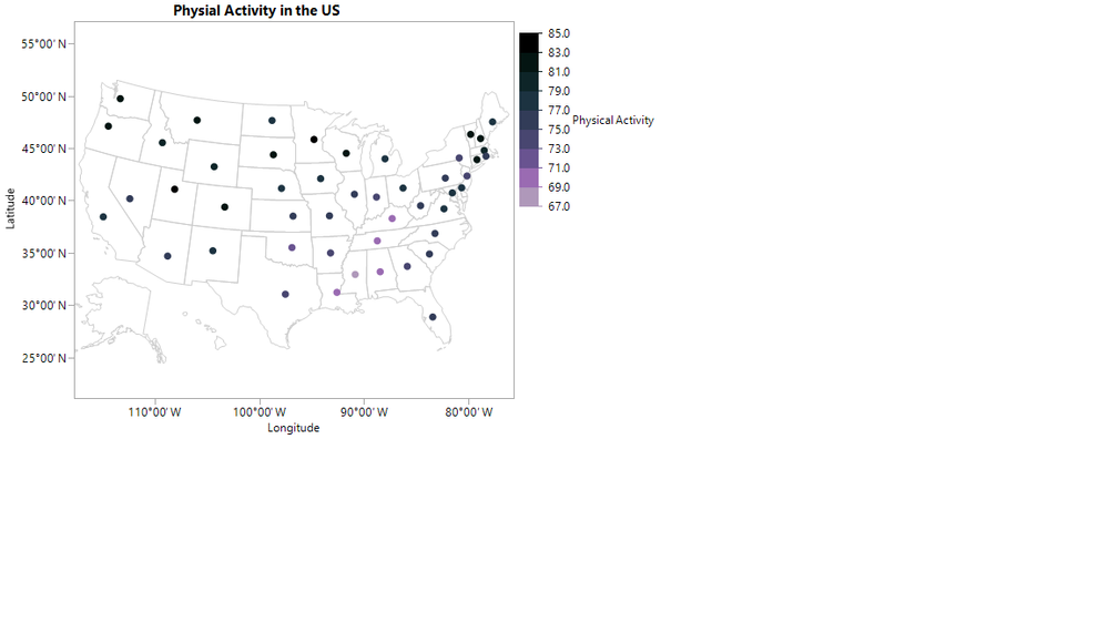

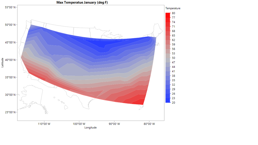

I would like overlay points from one data table onto a contour plot from a second data table without joining the data tables. I want to maintain the coloring and other properties from the points. I have tried to use the Copy/Paste Frame Contentents feature, however it provides the points but not the colors assigned to the points. Below is an example use JMP sample Data
A contour plot based on Cities.jmp
A map with points from US Demographics.jmp
However using Edit > Copy Frame Contents then Edit > Paste Frame Contents I lose the coloring properties of my points.

Here is my solution for anyone else wondering about this. I wish I had found a better way to do the coloring and to add a legend to go with the coloring for the points from the US Demographics.jmp table.
cities = Data Table("Cities.jmp");
window = cities << Graph Builder(
	Variables( X( :Longitude ), Y( :Latitude ), Color( :Max deg. F Jan ) ),
	Elements( Contour( X, Y, Legend( 8 ), Number of Levels( 20 ) ) ),
	SendToReport(
		Dispatch(
			"Longitude",
			ScaleBox,
			{Min( -120.427580183506 ), Max( -73.4774650353953 ), Inc( 5 ),
			Minor Ticks( 0 )}
		Dispatch(
			"Latitude",
			ScaleBox,
			{Min( 18.7755280157154 ), Max( 59.0478368517315 ), Inc( 5 ),
			Minor Ticks( 1 )}
		Dispatch(
			"Graph Builder",
			FrameBox,
			{Background Map( Boundaries( "US States" ) ),
			Add Graphics Script(
				5,
				Description( "Script" ),
				dt = Data Table( "US Demographics.jmp" );
				Marker Size( 4 );
				color = "";
				For( i = 1, i < N Rows( dt ), i++,
					If(
						:Physical Activity[i] <= 72, color = " Light Green",
						72 < :Physical Activity[i] <= 75.5,
							color = "Medium Light Green",
						75.5 < :Physical Activity[i] <= 79, color = "Green",
						79 < :Physical Activity[i] <= 82.5,
							color = "Medium Dark Green",
						82.5 < :Physical Activity[i], color = "Dark Green",
					Marker( Color State( color ), {:Longitude[i], :Latitude[i]} );
				Close( dt, nosave );
			), Grid Line Order( 3 ), Reference Line Order( 4 )}
