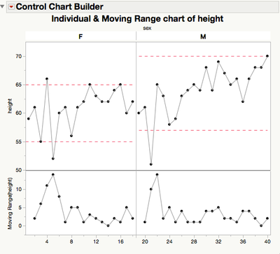

Hello,
I would like to build kind of IR Control chart with phases but with user defined limits for each phase instead of control limits calculated by JMP.
I tried it in Graph Builder but I cannot set X axises independent.
Please see screenshot of my trial in Graph Builder.
Thank you.

You can interactively add a graphics script to Control Chart Builder to draw the spec limits. To see an example run the code below.
NamesDefaultToHere(1);
dt << Control Chart Builder(
					Show Control Panel( 0 ),
					Show Limit Summaries( 0 ),
					Show Capability( 0 ),
					Variables( Y( :height ), Phase( :sex ) ),
					Chart(
						Position( 1 ),
						Limits( Sigma( Moving Range ), Show Center Line( 0 ), Show Limits( 0 ) ),
						Add Spec Limits( {LSL( 55 ), USL( 65 )} )
					Chart(
						Position( 2 ),
					SendToReport(
						Dispatch(
							"Control Chart Builder",
							FrameBox( 2 ),
							{Add Graphics Script(
								2,
								Description( "Spec Limits" ),
								Pen Color( "Red" );
								Line Style( "Dashed" );
				// Spec limits for Females
								H Line( 0, 18, 55 );
								H Line( 0, 18, 65 );
				// Spec limits for Males
								H Line( 19, 40, 57 );
								H Line( 19, 40, 70 );
							), Grid Line Order( 1 ), Reference Line Order( 3 )}
which gives:
With a little work, you could do this programmatically if you have many cases.
					Chart(
						Position( 1 ),
					Chart(
						Position( 2 ),
					SendToReport(
						Dispatch(
							FrameBox( 2 ),
								2,
								Pen Color( "Red" );
which gives:

Great!
Thank you!
