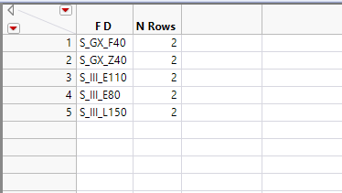

I now need to create the tabs which is based on my data table(i named as dt2). The names of the tabs is based on the dt2, meant here: if dt2 has 10 products name, so in my interface i also need have 10 tabs which is based on the product names in dt2.
One of my requirement is i cannot hardcode the coding, because in the future, maybe i need to add in the name of products in dt2, so the tabs will auto have same with the number of products name in dt2.
So, how to pull the data from dt2 and make it as tabs?
Actually i don't know how to write the code for the task that i need complete, i have try many times, but its keep runs out errors.
Thanks.
                                   dt2

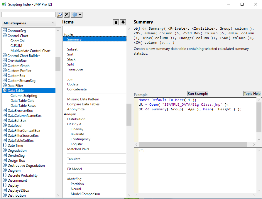

The description of the Summary Platform is found at:
Help==Scripting Index==>Data Table==>Summary
Here is an example almost itdentical to what is needed.
Names Default To Here( 1 );
dt << Summary( Group( :Age ), Mean( :Height ) );
But what seems to be missing is how to create a pointer to the summary table that will be produced by the Summary Platform.  However, you don't seem to understand how to reference data tables.  In the example, the variable "dt" points to the data table opened.  So as can be seen it is used when the Summary Platform references it.  However, you can also use a Data Table() function to point to the physical name of a data table.  Which is kind of what I think you are trying to do, with Data Table("Data Table.............").  Either one will work.......if you know the name of the data table.  But as you are showing in your provided code, make sure you specify a variable to point to the data table you will be creating from the Summary Platform, so you can use it in your next step ( i.e. dt = )
