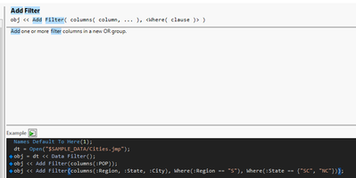

I found a way to tackle the issue with the
Include missing for grouping columns( 1 )
Use a Data filter with alien = 1 and dummy = 0 - and in addition set Count Excluded rows(1) [the default].
Then the data filter won't notice that for many age groups there are no rows with alien=1 and dummy=0.
Since it doesn't notice, it doesn't reset the selection :)

				Elements( Bar( X, Legend( 7 ), Summary Statistic( "N" ) ) ),
				Local Data Filter( Add Filter( columns( :alien, :dummy ), Where( :alien == 1 ) ) )
			dt << Graph Builder(
				title( "all students" ),
				Size( 700, 350 ),
				Show Control Panel( 0 ),
				Show Legend( 0 ),
				Variables( X( :age ) ),
				Local Data Filter( Add Filter( columns( :dummy ) ) )
