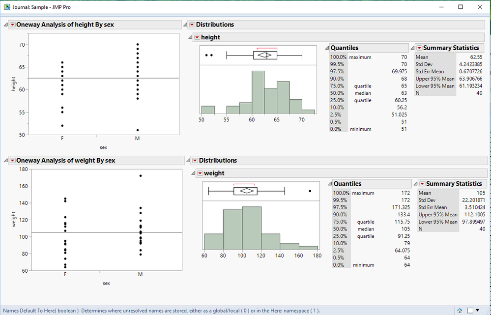

Hi,
Is there A way i can save my charts to journal using JSL? one chart next to the other (as row), And not just below (as column)
End goal is for journal with
Trend chart1 boxplot1
Trend chart2 boxplot2
Trend chart3 boxplot3
Appreciate your help, Adam.
Thanks, Adam
txnelson
Re: Organize a journal via jsl
There is a whole subsystem in JMP to do the kinds of things you are asking about.  A simple illustration is shown below.  This programming environment is detailed in the Scripting Guide
     Help==>Books==>Scripting Guide
Names Default To Here( 1 );
dt = Open( "$SAMPLE_DATA/big class.jmp" );
nw = New Window( "Sample",
	<<journal,
	V List Box(
		H List Box(
			Oneway( Y( :height ), X( :sex ) ),
			Distribution(
				Stack( 1 ),
				Continuous Distribution( Column( :height ), Horizontal Layout( 1 ), Vertical( 0 ) )
		H List Box(
			Oneway( Y( :weight ), X( :sex ) ),
			Distribution(
				Stack( 1 ),
				Continuous Distribution( Column( :weight ), Horizontal Layout( 1 ), Vertical( 0 ) )
Again, the above JSL is a very basic illustration of this facility in JMP.  Many other methods could have been used to accomplish this and far more complex outputs.
Jim
