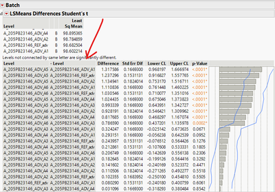

After running a least squares model by some variables we can have at the output window the ordered differences as the screenshot below illustrates.
Is it possible to take only the differences with the REF characterization in the level name.
Note that I have the name of the Reference assigned to the "batchRefChoice" variable. So is it possible to take a combined Data table having all the differences with the REFERENCE in the form:
Level               - Level
A1                      REF
A2                      REF
A3                      REF

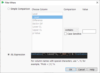

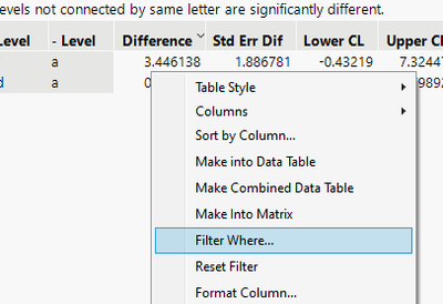

jthi
Re: Ordered differences combined data table - Outline Box
So perform the selection twice / utilize two conditions (-Level contains REF and Level doesn't contain REF)? You can also do the filtering in the table box but that is more limited and you would have to use JSL expression to have two conditions

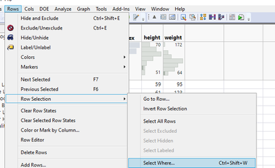

jthi
Make the combined data table, select rows from the -Level column which have _REF_, invert selection and delete rows (or pick rows which don't have _REF_ and delete rows). Select Where platform should be able to build the comparison
Use contains for the comparison

Georgios_Tsim
Level III
I would like to take the Combined Data Table having only the differences with the REF. But I want them in the form:
Level               - Level
A1                      REF
A2                      REF
A3                      REF
As you can see in the screenshot that I provided in my first question above, at the end of the table there is the REF indicator at the "Level" Column and not at the  "- Level".
But to explain wat I am asking:
In SAS you can do that providing the following line in the mixed process:
lsmeans condition/ diffs=control("REF") alpha=0.1;
and you get the following table:
is it possible that in jsl?
jthi
