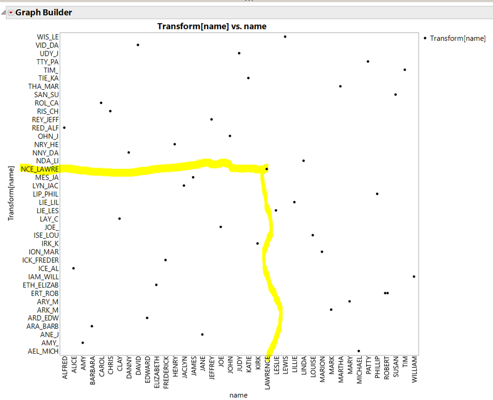

Maybe something like this. I created the transform column in the GUI, then saved it. Right-click the variable to transform (in the column selector), choose transform->formula. Then drag/drop the new transform variable into graph builder.
Graph Builder(
	Size( 893, 823 ),
	Show Control Panel( 0 ),
	Variables(
		X( :name ),
		Y(
			Transform Column(
				"Transform[name]",
				Character,
				Nominal,
				Formula(
					Right( :name, 3 ) || "_" || Left( :name, Length( :name ) - 3 )
	Elements( Points( X, Y, Legend( 8 ) ) )
Last three letters moved to front of nameLast three letters moved to front of name

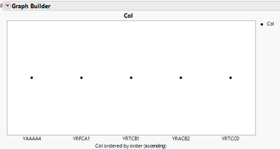

You can also "force" JMP to use ordering of non-numeric columns through JSL, but this might be a bug and not a feature so might be a bit risky to use:
Names Default To Here(1);
dt = New Table("table",
	Add Rows(5),
	New Column("Col", Character, "Nominal", Set Values({"YRFCA1", "YRTCB1", "YRACB2", "YRTCC0", "YAAAA4"})),
	New Column("order", Character, "Nominal", Formula(Right(:Col, 3)))

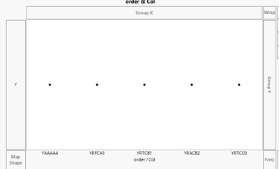

dt = Graph Builder(Variables(X(:Col, Order By(:order, Ascending))), Elements(Points(X, Legend(34))));

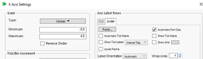

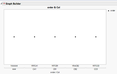

You can do it also directly from Graph builder by using two x-axis label rows:
Then if you want to you canopen x-axis settings and then do some modifications to other label's settings to hide it (in this case order):
and you end up with:
Then you could change the x-axis to remove the order /.
