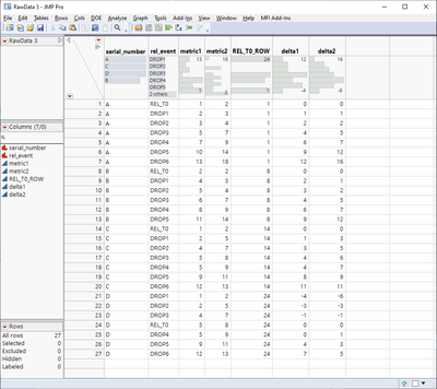

Yes, it is possible with small changes directly to that script. I added debug column which you can remove to show that it matches correct rows
Names Default To Here(1);
dt = New Table("RawData",
	Add Rows(27),
	Compress File When Saved(1),
	New Column("serial_number",
		Character,
		"Nominal",
		Set Values(
			{"A", "A", "A", "A", "A", "A", "A", "B", "B", "B", "B", "B", "B", "C", "C", "C", "C", "C", "C", "C", "D", "D", "D", "D", "D", "D", "D"}
	New Column("rel_event",
		Character,
		"Nominal",
		Set Values(
			{"REL_T0", "DROP1", "DROP2", "DROP3", "DROP4", "DROP5", "DROP6", "REL_T0", "DROP1", "DROP2", "DROP3", "DROP4", "DROP5", "REL_T0", "DROP1",
			"DROP2", "DROP3", "DROP4", "DROP5", "DROP6", "DROP1", "DROP2", "DROP3", "REL_T0", "DROP4", "DROP5", "DROP6"}
	New Column("metric1",
		Numeric,
		"Continuous",
		Format("Best", 10),
		Set Values([1, 2, 3, 5, 7, 10, 13, 2, 4, 5, 6, 8, 11, 1, 2, 4, 5, 5, 9, 12, 1, 2, 4, 5, 5, 9, 12])
	New Column("metric2",
		Numeric,
		"Continuous",
		Format("Best", 10),
		Set Values([2, 3, 4, 7, 9, 14, 18, 2, 3, 4, 7, 9, 14, 2, 5, 7, 8, 9, 11, 13, 2, 5, 7, 8, 9, 11, 13])
debugcol = dt << New Column("REL_T0_ROW", Numeric, Continuous);
delta1col = dt << New Column("delta1", Numeric, Continuous);
delta2col = dt << New Column("delta2", Numeric, Continuous);
For Each Row(dt,
	// find REL_T0 row for current serial_number
	start_row = Col Min(If(:rel_event == "REL_T0", Row(), .), :serial_number);
	debugcol[Row()] = start_row;
	delta1col[Row()] = :metric1 - :metric1[start_row];
	delta2col[Row()] = :metric2 - :metric2[start_row];
-Jarmo

But to add more context and make the script more robust, REL_T0 might not always be the first row per serial number (the database doesn't always query the data in the right order in the JMP table), and also the drift might be positive OR negative, so I don't know if Col Min() is well suited here (maybe I don't read it right).
Is it possible to anchor start_row to the REL_T0 value per serial number directly?
jthi
Re: Optimization of a (slow) JSL code based on FOR() loops

For Each Row(dt,
-Jarmo
