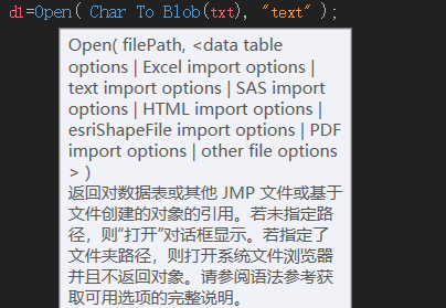

Re: How do I increment a loop using hexadecimal format?
txt="hex";first = {"A", "B"};
second = {"D", "E", "F"};
number = 9 :: 11;
For Each( {f}, first, //
	For Each( {s}, second, //
		For Each( {n}, number, //
			txt=txt||( Eval Insert( "\!n^f^^s^^right(char(1e6+n),2)^" ) )
d1=Open( Char To Blob(txt), "text" );
  • All to Craige! Learned it.
Thanks Experts!
Craige_Hales
@lala  - interesting example. Explanation: the open function usually uses a filename for its first parameter, but can take a blob parameter of the actual data, which requires a second parameter since there is no file extension. "text" means interpret the data as a text file, which means a CSV-like file. This CSV has one value per line and no commas.
Craige
