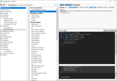

<< Name Selection In Column() is a message you can send to data table. This seems to only support strings for values though, so if you need numbers you have to use some other method
Names Default To Here(1);
dt << Select Where(:Age < 14);
dt << Name Selection in Column(
	Column Name("Younger"),
	Selected("Yes"),
	Unselected("No")

Re: "Name Selection in Column" function in JSL
Regarding the part about that jsl command only supporting strings, I just tried it with a 0 / 1 (removed quotes), and it worked ok. Resulted in a nominal numeric column. So, at least on JMP 17.2, it works. Though as you say, may not be always supported.
