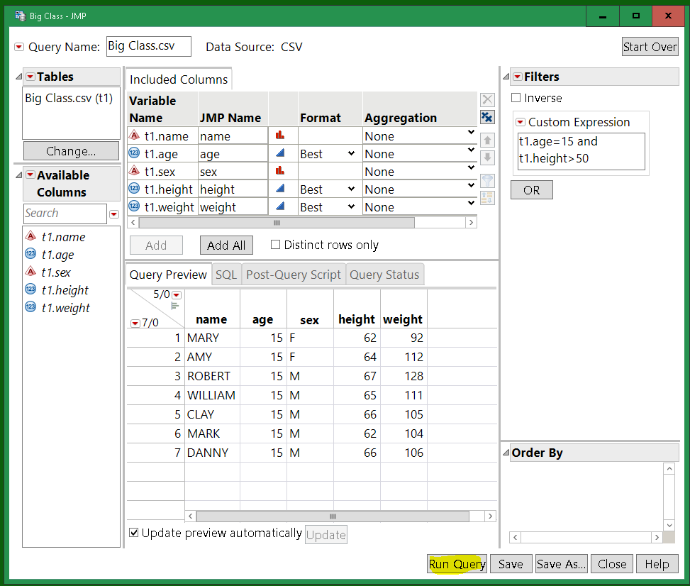

You can do it with an ODBC driver. It is complicated, and I'm not sure what kind of performance you can expect. The JSL first, then the complicated setup steps. I made big class.csv in the samples\import directory; the bigclass.txt did not work on my first try, probably because of the extension or not having commas. There might be a way to fix that in the connection string.

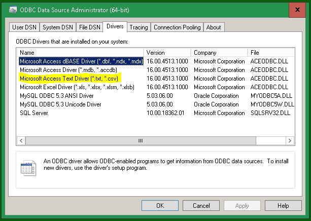

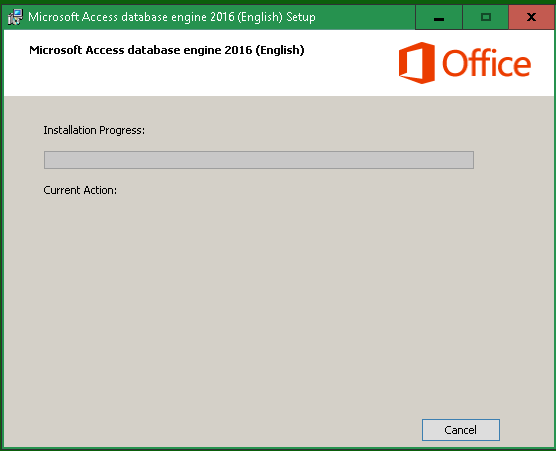

You'll have to set up a DSN on your computer. You probably don't have the driver. Download and install.

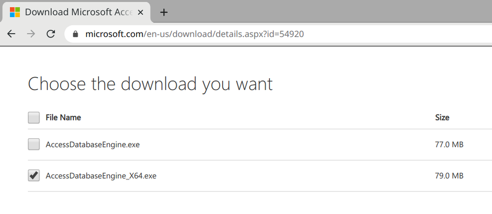

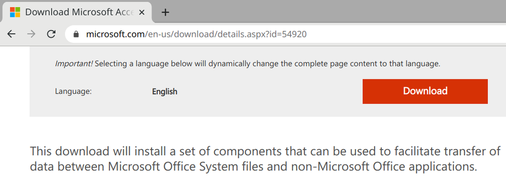

I found those by searching for the Microsoft Access ODBC CSV Driver
Install the 64 bit exe:
This took a minuteThis took a minute

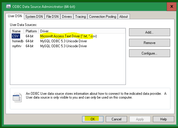

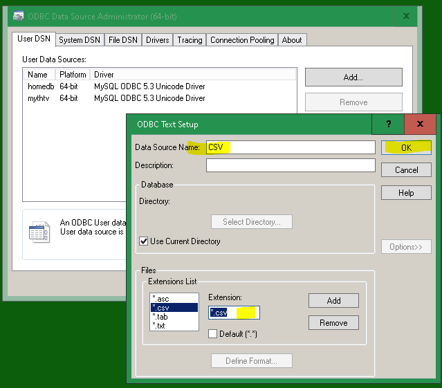

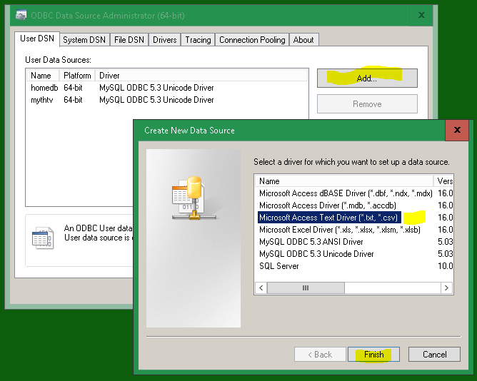

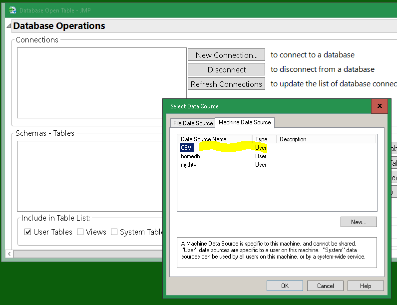

Set it up. Type ODBC in the windows start menu to find the 64 bit admin tool.

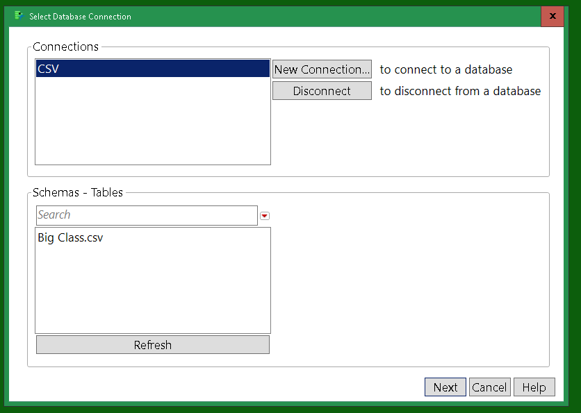

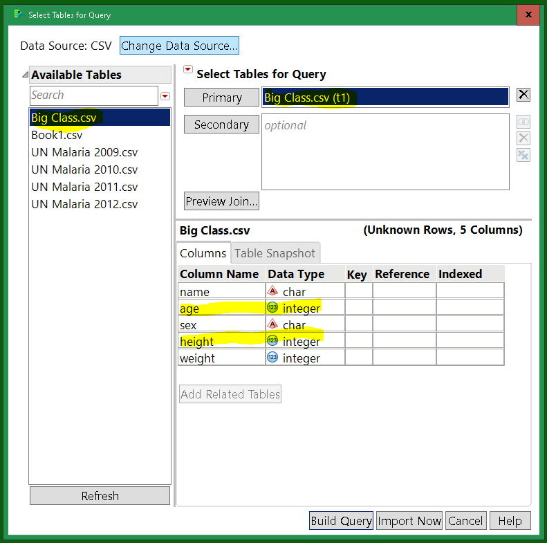

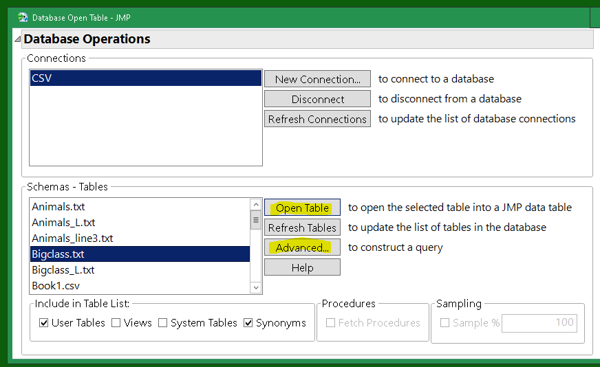

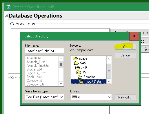

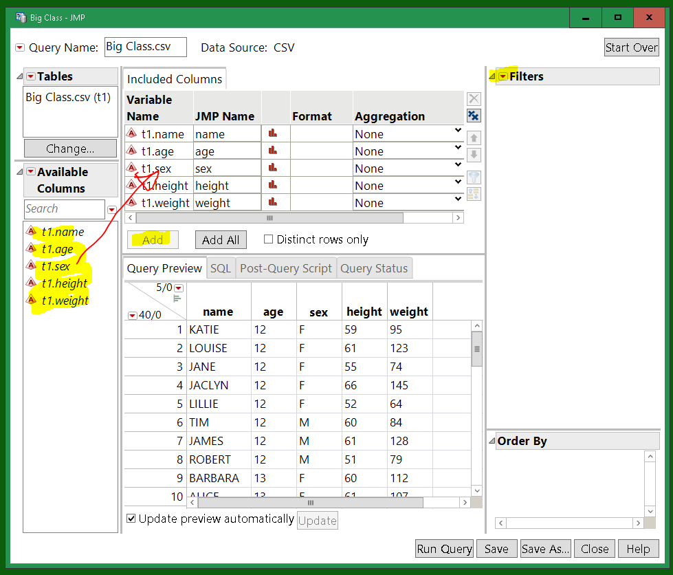

Use it in JMP. I stumbled about, some of the pictures may be less correct; the good stuff is at the end. File->Database is the starting point.
Capture7.PNGCapture8.PNGCapture9.pngcapture10.pngCapture11.PNGCapture12.PNGCapture13.PNGCapture14.PNG
I think the file needs a CSV extension, but I didn't do enough experiments. With a CSV extension, and using commas, and NOT using quotation marks around numbers, it works. It looks like quotation marks will import strings, but there might be a way to fix that too.
