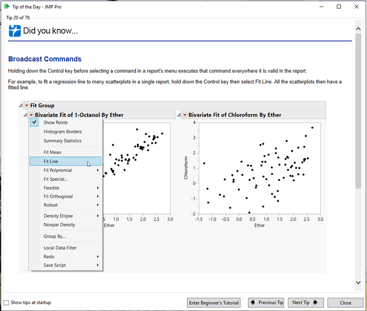

Sorry for resurrecting an old post, but I have a question on your answer.
I can create the fit x by y chart and it creates the graph I'd like. Then I can click the red triangle or right click the graph and add the tukey comparison.
My question is, if I have a hundred+ graphs, is there a way to add the tukey comparison to all the graphs? Or do I need to manually go through and add it to all of them?
Or is there a way to modify all the fit by x test results at once?
txnelson
Re: One way ANOVA comparing means.
I suggest that you read through the Tip of the Day, there it covers the ability to Broadcast the options by holding down the CNTL key when you make the Tukey Comparison selection, and it will be broadcast to all of the graphs that were created with Fit Y by X platform
Jim
