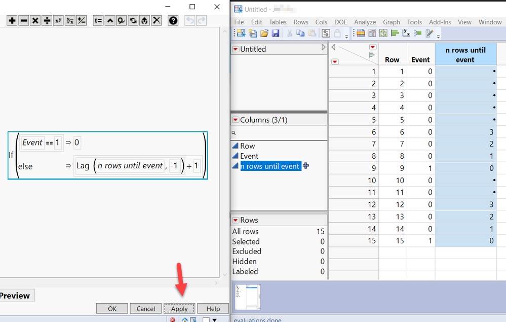

Without using JSL, is there a way to calculate a column that tells you how many rows are left until an event happens?
The following formula works but needs the user to click n times in "Apply"
Can we put this formula inside a for loop that 'applies it' n times?

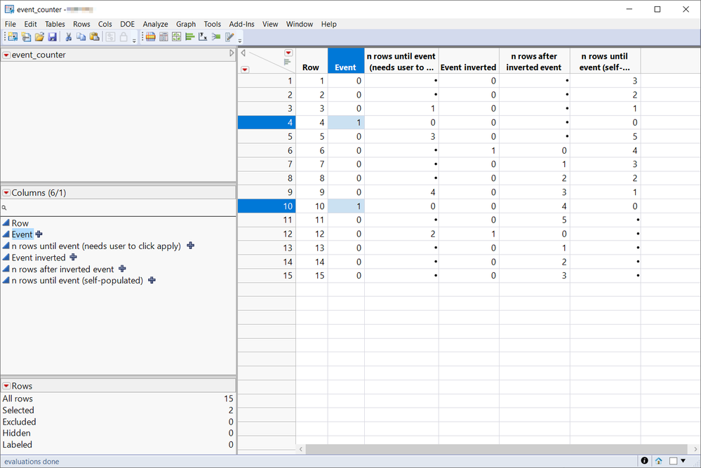

Re: Number of rows until event
Maybe we can use is the fact that the solution, if the row order is reversed, is self populated in JMP?
For example, this will reverse the order of the events.
Event reversed:
:Event[(N Rows() - Row()) + 1]
Now the values self-populate as the calculation works from top to bottom
n rows after the reversed event:
If( :Event inverted == 1, 0,
Lag( :n rows after inverted event, 1 ) + 1
Finally, we reversed that column.
:n rows after reversed event[(N Rows() - Row()) + 1]
Any ideas on how to do this in one formula which is easy to interpret?
