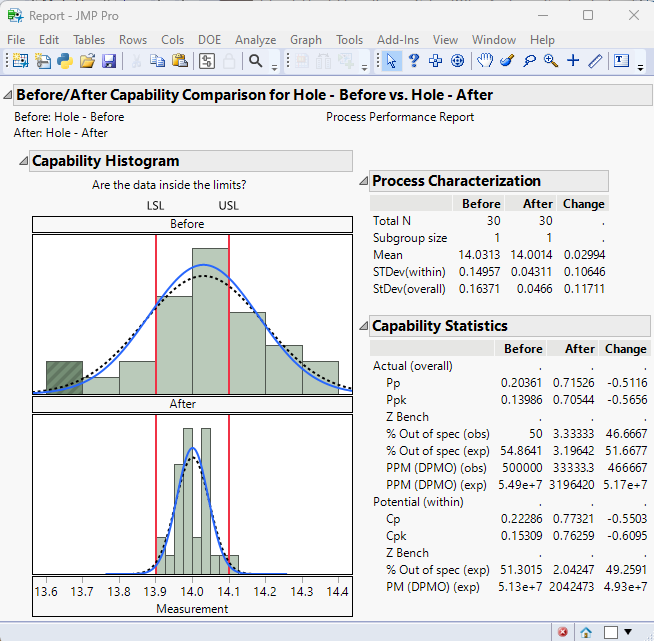

If you want to replicate the Minitab report form, here is a very ruff, hardcoded version.  It could be quite easily be put into a generic format and added as a JMP Addin.  But I will leave that to your efforts
This is using only JSL, taking the objects from the output I previously provided, and then reformatting into the Minitab form.  It needs a bunch of cleanup, and genericizing.
Here is the first pass at the code

dis << close window;
Jim

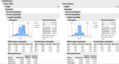

1. Yes. Use Analyze>Distribution, pick multiple variables.  Hold down the CTRL key, and hold it. From one of the variable name red triangle menus, fit a continuous distribution, CTRL broadcasts this to all variables, keep holding CTRL, from the fitted distribution model red triangle menu, click goodness of fit test.
2. for before and after, put your phase column in the By role when you launch the distribution platform.

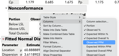

3. Right Click on the columns in the Nonconformance report, a menu pops up, click columns, and turn on the extra stats you need.

Re: Normality and Capability
You should have a column in your JMP table with a title like before/after.  When doing the Distribution platform, there is an option to fill out the By option.  Use the before after column in the By option and you will get the distribution before and after.

Please attach a JMP table.  I have attached a JMP table from the JMP data sets.  I have run the Distribution platform by machine. (there are many options).  Click on the green arrow for the script to run.
MichaH
Level III
Thanks, but you have logically 2 data sets, but I am searching for one overal comparing both like atatched
statman
I don';t know how to get the specific column in the analysis that compares the two capability studies.  As Jim has provided, the analysis of each is shown and you can do the comparison of values.  I personally would not use this platform (or the one in Minitab) to do a comparison of processes before and after changes were made.  Given two numbers, one will be bigger.  So what?
