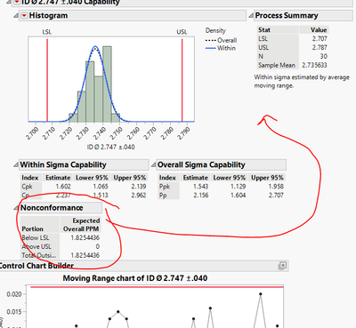

Hi.  I am very new.  Before I jump into learning Scripting, I would like to get a confirmation I am approaching this correctly.  We want an easy way to create the below simple Distribution report that can be created for a user selected column, typically 30 data points, that looks like the below pic and we are hoping to remove the items with red lines:
An example of a data table is:
Below is the script the system created when I used: Save Script/To Data Table:
Distribution(
Continuous Distribution(
Column( :OD ),
Horizontal Layout( 1 ),
Histogram( 0 ),
Vertical( 0 ),
Process Capability(
Use Column Property Specs,
Process Capability Analysis( Nonconformance( 0 ) )
Histograms Only,
SendToReport(
Dispatch( {"OD", "Process Capability", "OD Capability", "Histogram"}, "1",
ScaleBox,
{Min( 2.1388234375 ), Max( 2.1636765625 ), Inc( 0.005 ),
Minor Ticks( 5 )}
I am assuming this cannot be done without scripting.  If that is not true, please let me know.
What I am planning on doing is trying to learn how to script so the user can select the Column to use, where the above script only uses column "OD".  This would, hopefully, give the basic report above by running the script.
Then start looking for script changes to remove the entries that we have crossed out in red.
Is this approach naive?  Is there a better way to approach it?

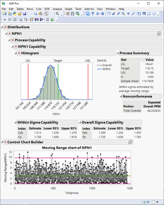

You can build something like this using Workflow builder, so depending on what you are doing utilizing that might be a good idea (and it is good practice on using JMP).
Names Default To Here(1);
dt = Open("$SAMPLE_DATA/Semiconductor Capability.jmp");
run_custom_dist = Expr(
	vlb = V List Box(
		dist = dt << Distribution(
			Ignore Platform Preferences(1),
				Column(Eval(mycol)),
				Quantiles(0),
				Summary Statistics(0),
				Horizontal Layout(1),
				Histogram(0),
				Vertical(0),
				Outlier Box Plot(0),
				Process Capability(Use Column Property Specs, Process Capability Analysis(Nonconformance(0)))
		ccb = dt << Control Chart Builder(
			Show Two Shewhart Charts(0),
			Include Missing Categories(0),
			Show Limit Summaries(0),
			Show Capability(0),
			Variables(Y(Eval(mycol))),
			Chart(Points(Statistic("Moving Range")), Limits(Sigma("Moving Range"))),
			Show Control Panel(0)
	// modify axis
	Report(dist)[Outline Box("Histogram"), AxisBox(1)] << Min(100) << Max(130) << Inc(1) << Minor Ticks(5);
	// Filter table boxes
	Report(dist)[Outline Box("Within Sigma Capability"), Table Box(1)] << Filter Where(Contains({"Cpk", "Cp"}, Index));
	Report(dist)[Outline Box("Overall Sigma Capability"), Table Box(1)] << Filter Where(Contains({"Ppk", "Pp"}, Index));
	Report(dist)[Outline Box("Process Summary"), Table Box(1), String Col Box(1)] << Set Heading("Stat");
	Report(dist)[Outline Box("Process Summary"), Table Box(1), Number Col Box(1)] << Set Heading("Value");
	Report(dist)[Outline Box("Process Summary"), Table Box(1)] << Filter Where(Contains({"LSL", "Target", "USL", "N", "Sample Mean"}, Stat));
	nw = new window("",
		vlb
nw = New Window("UI",
	H List Box(
		Panel Box("Pick Columns",
			window:fcs = Filter Col Selector(dt, << Character(0))
		Panel Box("Cast",
			Lineup Box(N Col(2),
				Button Box("Column", << Set Function(function({this},
					(this << sib) << Append(window:fcs << get selected)
				window:clb = Col List Box(dt, Min Items(1), Max items(1), N Lines(2), << Modeling Type({"Continuous"}))
		Panel Box("Actions",
			Lineup Box(N Col(1),
				Button Box("OK",
					sel = window:clb << get items;
					If(N Items(sel) > 0,
						mycol = sel[1];
						run_custom_dist;
						window:fcs << close window;
				Button Box("Cancel", window:fcs << close window);
Write();
How something like this should be used is totally up to you, for me it would maybe make most sense to have a workflow for this (fixing the distribution could be a bit difficult without JSL for workflow though) OR create an add-in which user could run on their own table as needed. For add-in purposes I would most likely let user select more than one column or utilize column switcher and it would be a good idea to implement some extra checks (is table open, do the selected columns have spec limits and so on).
Edit: Fixed hard-coded value from Control Chart Builder
-Jarmo

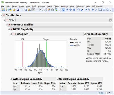

For capability tables this is fairly easy as you can use filter such as
But this does not work for the table box below Process Summary as it doesn't have column names... so you cannot easily utilize Presets for example.
So utilize scripting. With scripting you can add those headers to the table box and then use them for filtering
mycol = "NPN1";
		Quantiles(0),
		Histogram(0),
		Vertical(0),
		Process Capability(
// modify axis
Report(dist)[OutlineBox("Histogram"), AxisBox(1)] << Min(100) << Max(130) << Inc(1) << Minor Ticks(5);
Report(dist)[OutlineBox("Within Sigma Capability"), TableBox(1)] << Filter Where(Contains({"Cpk", "Cp"}, Index));
Report(dist)[OutlineBox("Overall Sigma Capability"), TableBox(1)] << Filter Where(Contains({"Ppk", "Pp"}, Index));
Report(dist)[OutlineBox("Process Summary"), TableBox(1), StringColBox(1)] << Set Heading("Stat");
Report(dist)[OutlineBox("Process Summary"), TableBox(1), NumberColBox(1)] << Set Heading("Value");
Report(dist)[OutlineBox("Process Summary"), TableBox(1)] << Filter Where(Contains({"LSL", "Target", "USL", "N", "Sample Mean"}, Stat));
-Jarmo

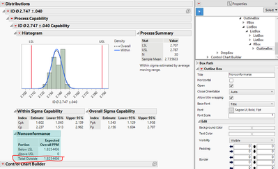

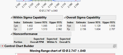

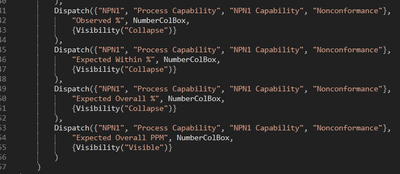

I thought it would make sense to ask here instead of making a new topic...
I have made good process and made an Add-in for our group that is in use.  Trying to learn more, I am looking to add just the "Total Outside" row and only the "Expected Overall PPM" column from the Nonconformance section (underlined in red in the below capture):
I can get the box to show, but no values...  Below is the section of the script (Lines 50-52) for this and a screen capture:
	Report(dist)[Outline Box("Nonconformance"), Table Box(1), String Col Box(1)] << Set Heading("Portion");
	Report(dist)[Outline Box("Nonconformance"), Table Box(1), Number Col Box(1)] << Set Heading("Expected Overall PPM");
	Report(dist)[Outline Box("Nonconformance"), Table Box(1)] << Filter Where(Contains({"Total Outside"}, Expected Overall PPM));
Notice in the screen capture it also added columns "Expected Within %" and "Expected Overall %", which I do not want.
I know I am missing something basic...  I tried using the properties for the items to compare what is different, but I don't see anything in value.  I also tried the Save Script tool to see if that helps give a clue, but it uses a Dispatch command and I can't get that to work either...
Also, is it possible to make the "Noncomformance" section be placed directly under the "Process Summary" and over "Overall Sigma Capability"?  I didn't think so from what I've searched, but I may be missing something there too.
Thank you,
Grant

You can modify the columns you which you wish to show first by using JMP and checking the script JMP creates to see IF JMP can capture what you wish to do (in this case it can). You can then either leave it to the distribution script or move it outside of it.
And in your script it could look something like this
Report(dist)[Outline Box("Nonconformance"), NumberColBox("Observed %")] << Visibility("Collapse");
Report(dist)[Outline Box("Nonconformance"), NumberColBox("Expected Within %")] << Visibility("Collapse");
Report(dist)[Outline Box("Nonconformance"), NumberColBox("Expected Overall %")] << Visibility("Collapse");
Report(dist)[Outline Box("Nonconformance"), NumberColBox("Expected Overall PPM")] << Visibility("Visible");
Report(dist)[Outline Box("Nonconformance"), Table Box(1)] << Filter Where(Portion == "Total Outside");
You can also use clone box to "copy" the non-conformance
ncob = Report(dist)[Outline Box("Nonconformance")];
(Report(dist)["Process Capability","? Capability","Process Summary"] << parent) << Append(
	ncob << clone box;
(ncob << parent) << Set(0);
But if you don't need the functionalities of these JMP platforms, I would consider building custom report from different parts. This way you can control how the report will look like more easily and users won't by accident try to use those features which might not even work properly.
