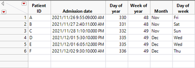

Each row represents an individual admission, and columns contain variables like date of admission (YY/MM/DD hh:mm) or source of admission (home, transfer from other hospital, etc).
This is a very simplified version of how my table looks like. Actual table contains thousands of admissions. Admission date is in ascending order.

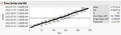

The only way I have been able to get some output was by using by admission date variable in the Y axis, and I am getting something like this:

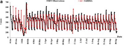

Instead, I am hoping to get something like this:

I cannot see the y-axis label in your targeted result due to resolution. But I believe that is not in your data. So a hint is can you get the data into the shape that is required for your targeted plot?
