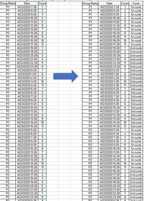

Refer to below data table, how to New Create A column to count Cycle Time? kindly help to suggest. thanks a lot.
1.need sort properly by "Group Name" and "Date".
2. within same "Group Name", with "Date" increase, column"Count" number increases, after a certain level (the max value maybe not fixed, sometimes change), it will be back to small value, which means another cycle start.

qspringleaf
Level III
Re: New Create A column to count Cycle Time
thanks a lot, it works well for one group name, still need your suggestion on multiple group names.
actually this table have one column named "group name", in this column have P1 and P2 2 groups, what I want is "P1/P2 count cycle time separately".
so P2 start to count from "1" instead of "4".
thanks a lot.
