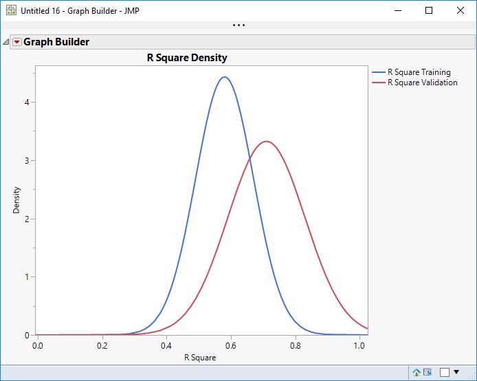

I am not sure but I think that the claim is not of superiority. It is based on the difference in the mean R square between the training and the validation sets. In fact, one can't be superior because the sampling distributions overlap. Using a normal distribution to approximate the sampling distribution of R square, I get these two graphs of the normal PDF using the stated distribution parameter values:
NOTE: I know that R square is not normally distributed because of its bounds [0,1] but this case is far enough away from both boundaries for the approximation to work well enough.

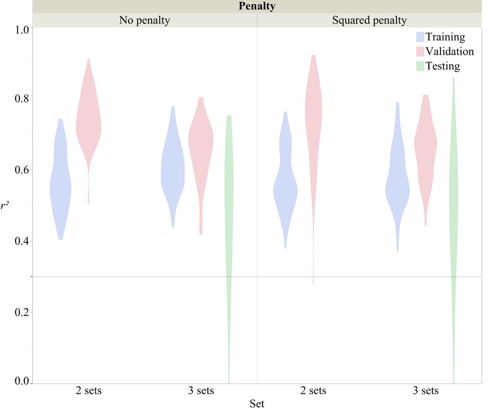

    Thanks for the suggestions. Yes, 1000 iterations mean that we have 1000 random splits of the data set. And it is true that the R squares for the validation sets are not always bigger than the training sets (see the Figure). But the mean of the R squares oth the validation sets is always bigger than that of the training sets for all our response parameters. I am doing the analyses with k-fold now. Let's see what would happen.
