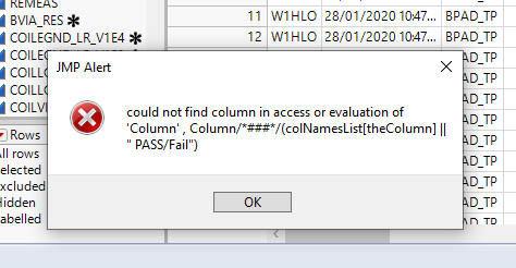

I an getting following error in the script you send me on Friday. Any help

The line of code that is having an issue, is
Column( colNamesList[theColumn] || " PASS/Fail" ) << delete formula;
The error statement is saying that it can not find the column that is being referenced.  The column being referenced should have been created in the statement just before.
dt << New Column( colNamesList[theColumn] || " PASS/Fail",
							numeric,
							CONTINUOUS,
							FORMULA( If( __LSL__ <= __col__ <= __USL__, 1, 0 ) )
What is required for this statement to work, is that both an LSL and a USL exist for the column being referenced in the formula.  I suspect this is the issue.  I would check to make sure that both LSL and USL exist.

Hi,
I did that check and made sure that LSL and USL both should be there in specs table. In fact, I also start the For loop -- the Column = 10 where I knew that from column 10th onward, I have specs limits in the table, though it should be taken care by Is Empty statement.
Nothing worked.
Thanks.
txnelson
Re: Need to compare result from one table with spec limit in another table. If result < limit th
The Manage Spec Limits, may not be finishing before the code below is processing.  Try running just through the Manage Spec Limits.  Then once it is complete, run the remaining code.
