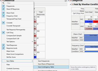

From the report you would basically just save the table and be almost done (some cleanup might be required depending on your final result)

dt_cont = cg1 << Save Contingency Table();
