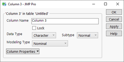

Format Pattern is usually the best option to format dates (and times) in JMP (in my opinion). You would do this most of the time interactively in JMP (sometimes this can be a bit annoying to get working or understand how it works though).
Starting point character nominal

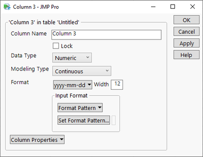

Change to Numeric Continuous and change format (do not press Apply or OK yet)

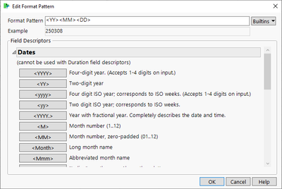

Click set format pattern, set the format provided by @mmarchandFSLR
And then click OK (or apply first).
