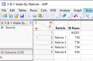

Hello JMP Community,
A bit challenging problem - I am trying to select Name Selection in Column
matrix [X,Y] of 26 x 29 points.
Create a Column in the data table and highlight them as below
Is there a way to Name all the with jsl instead of manually selecting and naming them?
I have attached the XY table
Any suggestions would be much appreciated :)
Thanks a lot,
The best community
