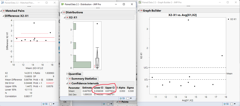

There isn't a way to do it inside the Matched Pairs platform, but you can recreate the analysis with some new formula columns  in the table (the graph in matched pairs tells you what the formulas need to be), then do whichever further analysis you need on those new columns. For example, if all you want is a graph with different confidence intervals, then you can use the Distribution platform and ask for a custom interval, then use the Graph Builder to make the new graph with those custom intervals. I've attached a sample data table with scripts saved to it.

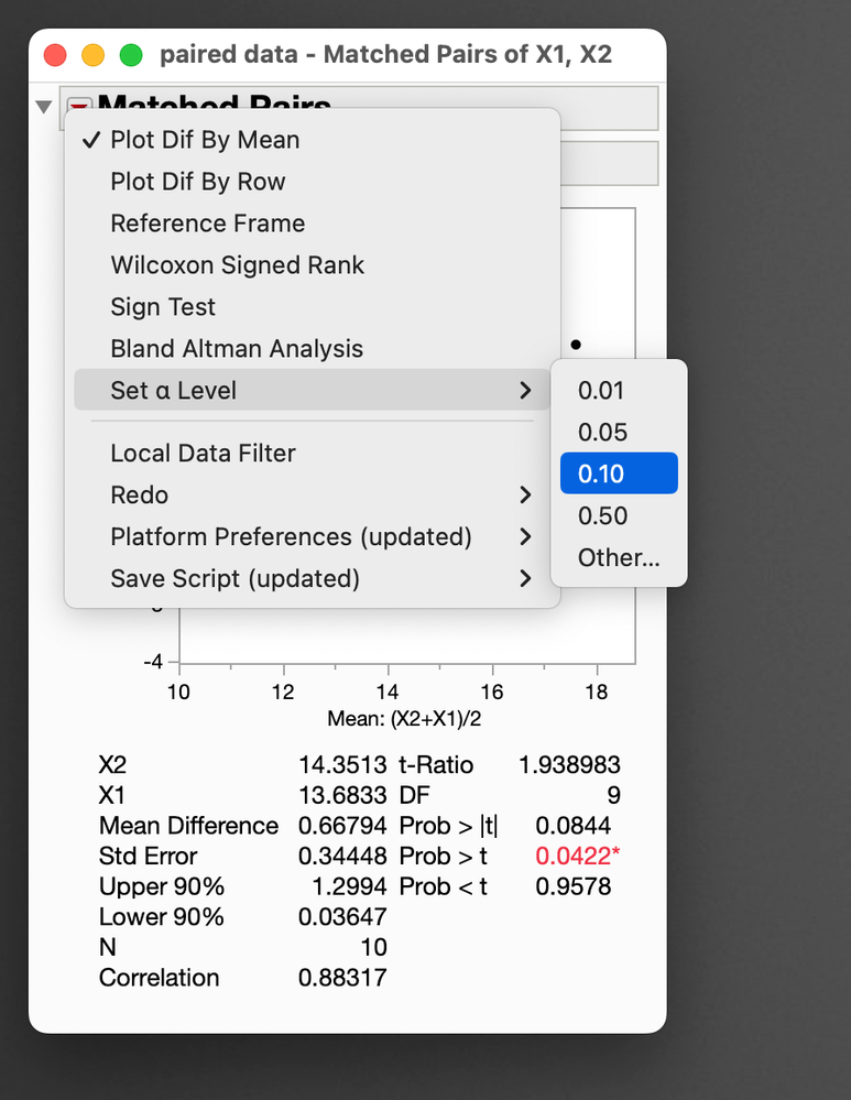

In the Matched Pairs platform (Analyze > Specialized Modeling > Matched Pairs), you can change the confidence level for the confidence intervals by changing the the alpha level.
To do this, click the Red Triangle, go to "Set α level," and then pick the alpha level that corresponds to your desired confidence level. For example, if you wish to form 90% confidence intervals, that's equivalent to an alpha level of 0.10 (confidence level = 1 - alpha level).
In the image below I have changed the alpha value and you can see 90% confidence intervals are being reported. The confidence limits about the mean difference in the difference plot are also updated to match this level of confidence.
I hope this helps!
