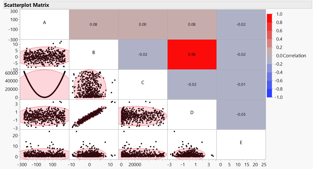

1. There is 5 variables (A, B, C, D, E). I created these data for explanation purposes.
2. If I wanted to check if these 5 variables are "related", then we can use Multivariate options which provide the
    correlation value.
3. The correlation value provided are based on linear relationship between the variables.
    Example : B vs D , Correlation = 1.00.
    Example : A vs C , Correlation = 0.00. However there is a relationship between A & C which is quadratic.
My question is:
Is there any statistical method that can provide a quick look into relationship (rather than correlation) between
variables?
Alternatively, I could perform the Fit Model manually with all the combination of the variables. But this is too time consuming.
Example is to have same scatterplot matrix below, but with option to provide the P(value) from a Ftest (ANOVA) to check if there is relationship between the variables. Let's say up to quadratic term.
Example : B vs D , Correlation = 1.00 & P(value) from F(test) is <0.0001
Example : A vs C , Correlation = 0.00 & P(value) from F(test) is <0.0001
Thanks to advise.

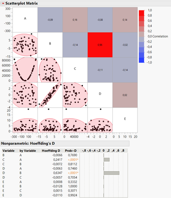

I would recommend plotting the data like you did in order to find unusual patterns using the platform Multivariate. I also see (at least) two ways to identify complex relationships/associations between your variables :
  1. In the Multivariate platform, you can also use different Nonparametric Measures of Association. Using a reproduction of your example, the Hoeffding's D test is able to spot the quadratic relationship between A and C :

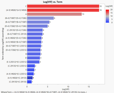

  2. You may also create a dummy response Y (no matter if it's fixed values or random values), and based on terms introduced in the model, display the Variance Inflation Factors in Parameter Estimates panel (right-click on the table, click on column and select VIF if they are not displayed by default). High VIFs indicate a collinearity issue among the terms in the model.
    In a reproduction of your example, visualizing the VIF (through their log values, because they are very high !) enable to identify possible collinearity issues :
    Term AxA, A and C have very high VIF values, indicating a collinearity issue. Many other terms display VIF with large values (higher than 5-10), so you can easily identify there are collinearity issues with this dataset.
