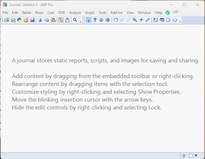

I went to
      File=>New=>Journal
and created an empty journal

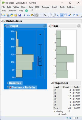

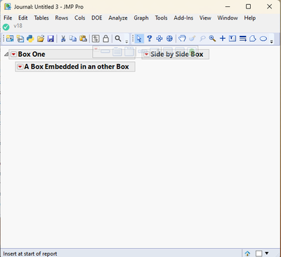

Then using the Editing tool bar
I dragged and dropped Outline Box objects to create a simple layout

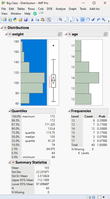

I then ran a Distribution Platform

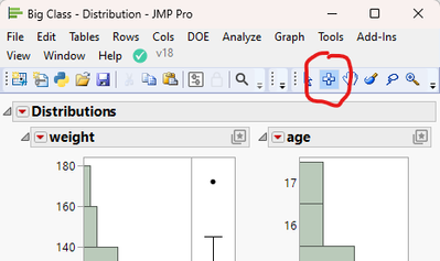

Using the Tool Bar in the Output Display I selected the thick "+" selection tool,
which allows one to select any of the objects in the display
or
Here I selected the Weight Outline Box, which will select everything under the Outline Box.  Items under an outline box that are not to be copied can be eliminated from the copying by simply clicking on the grey triangles and collapsing the box.  See above.

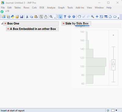

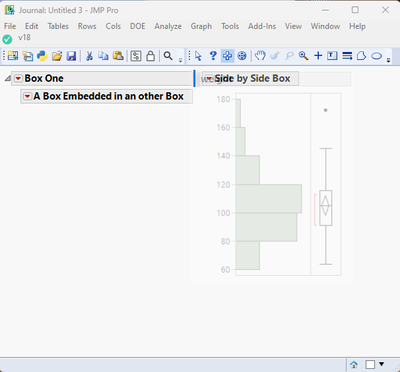

Now to move the display to the desired location in the journal, just drag and drop the selected display to the position in the journal
 It could be located under the Side by Side Box
Or it can be placed between Box One and the Side by Side Box

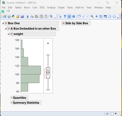

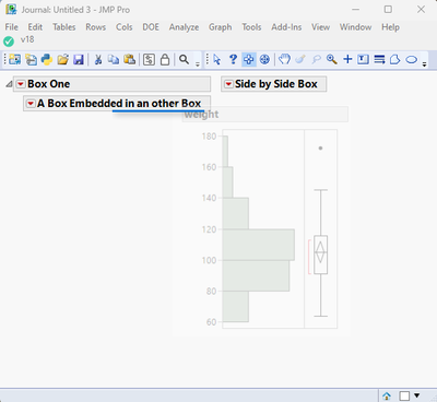

But for illustration, I chose to add it under the "A Box Embedded in an other Box
Using the selection tool in the Journal, one can select the objects and move them wherever wanted

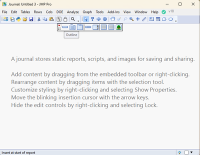

When you open a new, empty journal, JMP provides a drag and drop tool box that allows you to drag display object and place them in the journal window. If you want to add a script button you just have to drag the script button icon from the tool box and place above, below or to the side of whatever object in the journal you want,  Once you do that, it opens the editor and there you can paste or type in the script you want run as well as inputting the text to be displayed in the journal.
