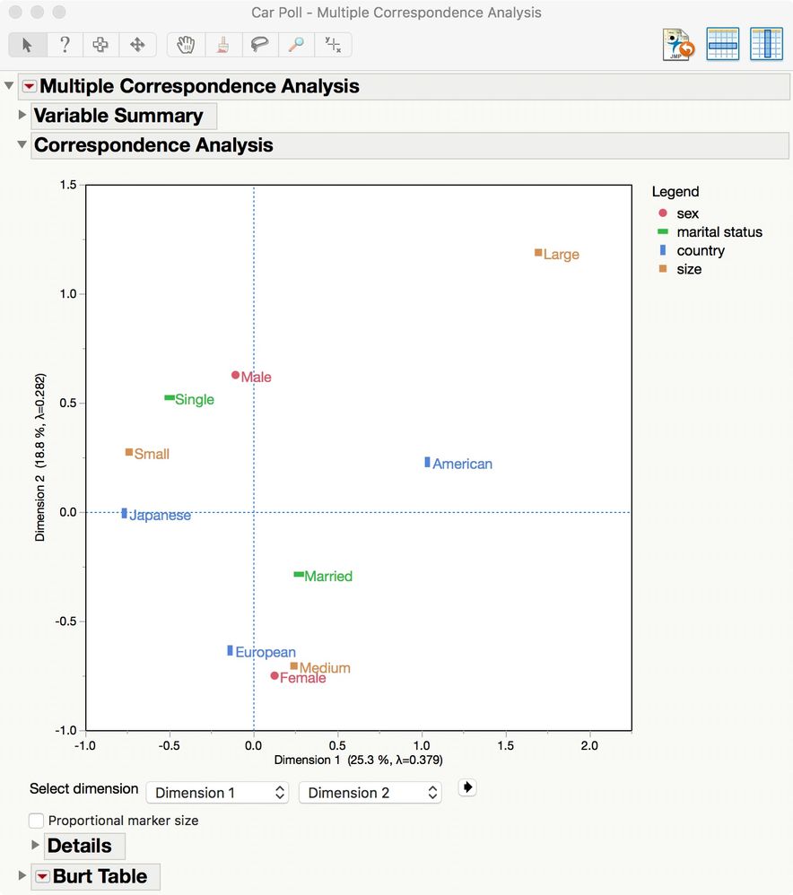

I have re-created the Car Poll example at the beginning of chapter 4 about Multiple Correspondence Analysis in the Consumer Research guide book for JMP 13:
I used the Correspondence Analysis > Save Coordinates command in the red triangle menu at the top to produce the same plot in Graph Builder. I used Rows > Color or Mark by Column and then manually adjusted the axes (scaling, add reference lines at 0) to finish:
So you should be able to re-produce the same plot as well. We can walk through the steps here or you can study this platform on your own with the guide book (select Help > Books > Consumer Research).
The MCA method is also known among the myriad multi-dimensional scaling methods as 'optimal scaling.' I am not sure what you mean when you say that you "want to move the extreme points out to break apart the overlaps between near concepts." The point of MCA is to show variable association between the individual levels. This plot is an analytical graphic and the coordinates are determined by the data based on their associations.
Note that you can manually drag the labels from their original positions if the plot is cluttered in one particular area where the associations are strong and they overlap.
