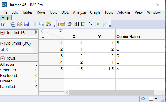

I am not sure what you actually are looking for, but if the table below is it, the script following the table will generate the corner names
Names Default To Here( 1 );
dt = Current Data Table();
dt << New Column( "Corner Name", character );
dt:Corner Name[dt << get rows where( :x == Col Min( :x ) & :y == Col Min( :y ) )] = "B";
dt:Corner Name[dt << get rows where( :x == Col Min( :x ) & :y == Col Max( :y ) )] = "C";
dt:Corner Name[dt << get rows where( :x == Col Max( :x ) & :y == Col Max( :y ) )] = "D";
dt:Corner Name[dt << get rows where( :x == Col Max( :x ) & :y == Col Min( :y ) )] = "E";
dt:Corner Name[dt << get rows where( :x == Col Mean( :x ) & :y == Col Mean( :y ) )] = "A";

Thank you for the quick response! I like solution 1 better and that was what I was looking for.
To get to a step further, my data looks like this and i have to define 2 conditional statements for 2 different scenarios.
1. When data has only 1 A corner at the center of the square
2. When data has 2 points at the center call them: A-Top and A-bottom (with the same X-cordinate)
Depending on the data present in the data table, I am trying to write the script to name the corners like below (in that order).
