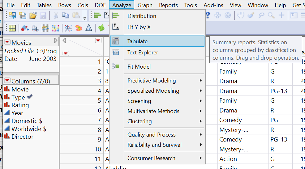

i would attempt using other platforms to produce the final table you are looking for.
the first thing that comes in mind is Analyze >> Tabulate.

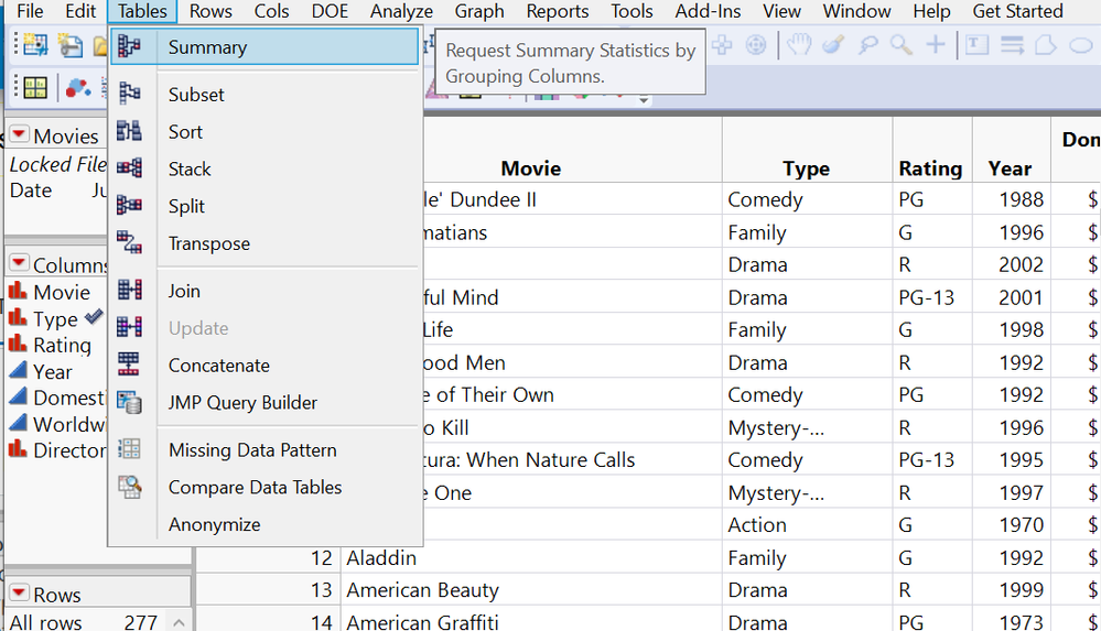

second option: Table >> summary
i find these much more versatile and controllable.
please let us know if this helps at all.
ron
