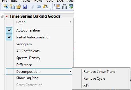

Here gives Decomposition Reports contains:
  1. Linear Trend Report
  2. Cycle Report
  3. X11 Report
There are no decomposed components.

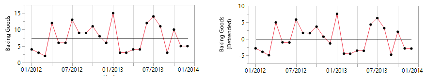

An example below: when compare the original time series plot and detrended plot, there's no obvious difference. So in this case, there's no trend can be extracted?

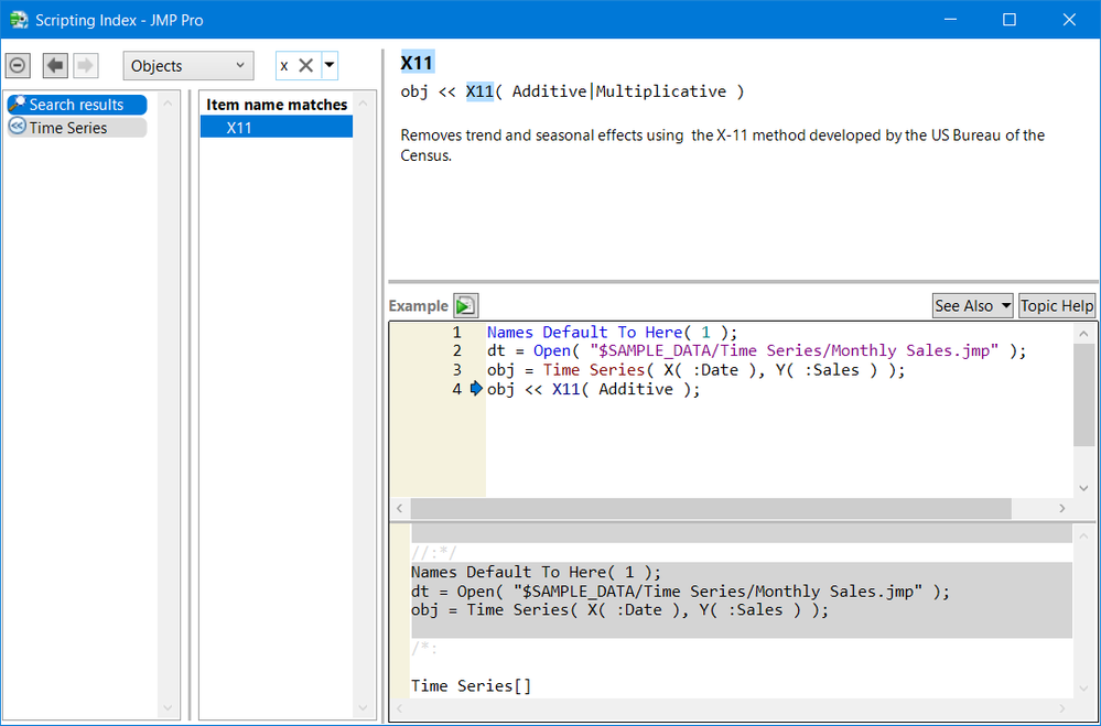

JMP provides wonderful examples of its platform options in the JMP Main Menu > Help > Scripting Index > Objects. Scroll to Time Series or search for X11 or some option in the platform. The Scripting Index provides a script that you can run and see an example.
The picture below is a screenshot of the Scripting Index after searching for x11 (not case sensistive). This sample data set has a 12 month (seasonal cycle) and large trend.  Pressing the "Go" button to the right of  "Example" will run the script and display the detrended series.
While your data might not contain a modeled component, you might want to use an Individual Control Chart and apply trend rules so look for possible non-randomness.
