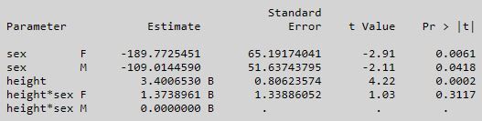

Here is the SAS output:

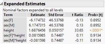

First of all, you requested a linear model without an intercept. Simply check this option in the middle of the bottom of the Fit Model launch dialog. Click the red triangle and deselect Center Polynomials. Click Run. Then click the red triangle at the top and select Estimates > Expanded Estimates.
Here is the JMP output:
The estimates are different because JMP parameterizes the terms differnently than PROC GLM. Is this report what you are looking for?

Thanks for your quick reply.  Your example actually illustrates my point.  The intercept estimates from SAS do not match those from JMP, not even close.  The intercept estimates from JMP appear to be deviations from something, but it is not clear to me what that could be.  The situation becomes even more unclear if you run the model with the "height" main effect.

Using the BigClass data, this is what I get from PROC GLM with MODEL weight = sex sex*height / noint solution;
Parameter
Estimate
Standard
Error
t-valuePr > |t|
sex F-189.772545165.19174041-2.910.0061
sex M-109.014459051.63743795-2.110.0418
height*sex F4.77454911.068892624.47<.0001
height*sex M3.40065300.806235744.220.0002

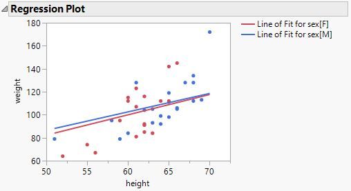

The interpretation of the two sex parameter estimates is that they are the intercepts for F and M and the height*sex parameter estimates are the F and M slopes.  The tests in this table are testing whether these parameter estimates are significantly different from zero.  My original question primarily concerned how to duplicate this table in JMP.  The graph produced by Fit Model is the same as the graph produced by PROC GLM, but the parameter estimates tables are very different.
