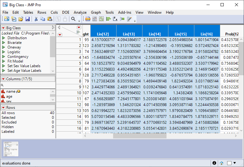

You can also save the probability formulas. JMP saves the linear predictor, the transformed probabilities, and the most likely level given the probabilities. Here is the group of linear predictors for the log odds.

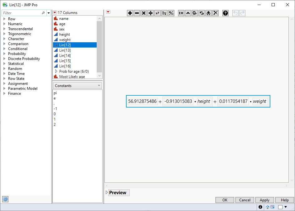

Here is the formula for the first linear predictor:

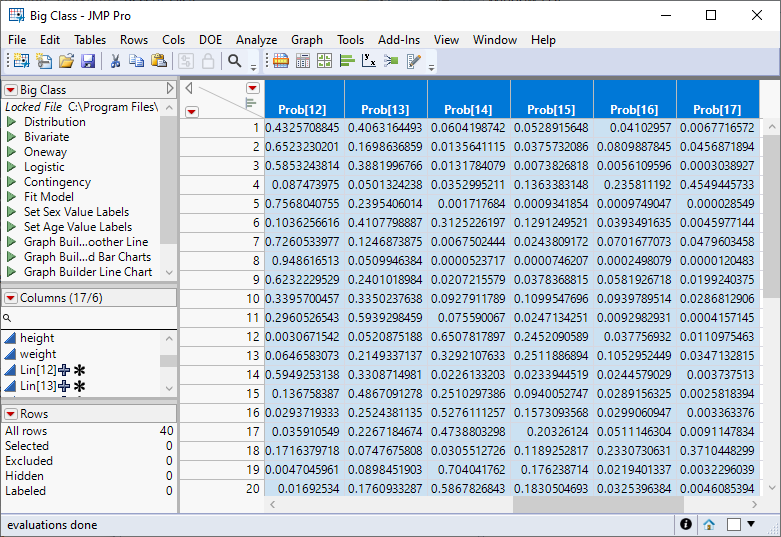

The numbers are the parameter estimates. The next group of formula columns transforms the log odds back to probability:

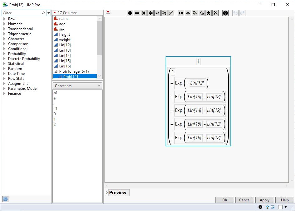

Here is the formula for the first probability transformation:

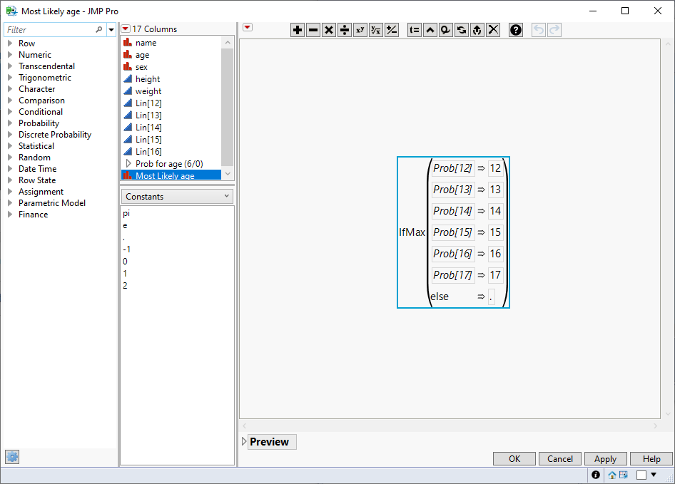

Finally, the predicted response level is the response level with the highest probability:
