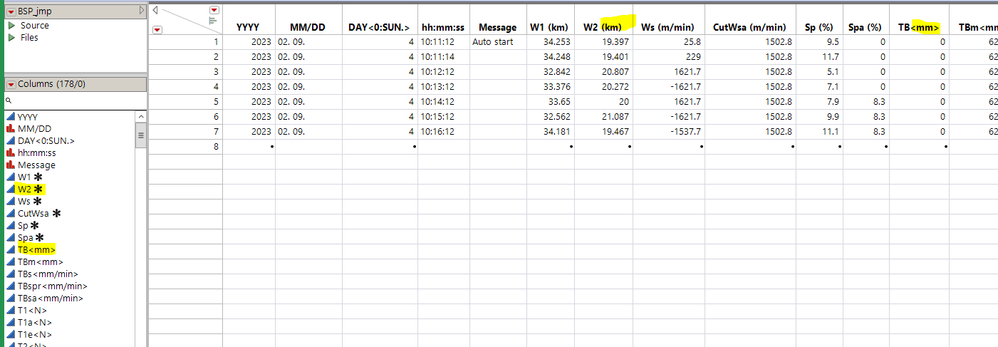

Hello,
Is there an option in JSL to read in the first two lines of a text file as a column header or
alternatively (and even better) the first as Column name and the second as the column property (Units)
Thank you
Mirko

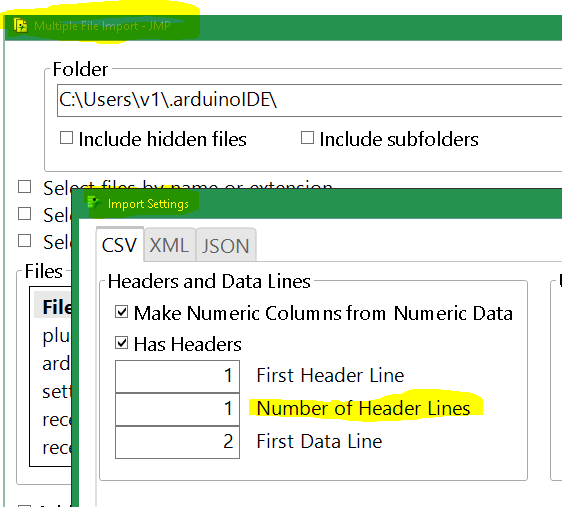

Craige_Hales
Re: How to read two rows from txt-file as column name
Multiple File Import can do it, even for a single file.
Craige

mlo1
Level IV
Thank you very much for the support.
I prefer this JSL solution.
The multiple file import works fine too but adds an “_” to the header name.

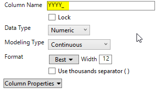

Craige_Hales
Craige

Craige_Hales
dtlist = Multiple File Import(
	<<Set Folder( "Z:\" ),
	<<Set Name Filter( "BSP_JMP.txt" ),
	<<Set Name Enable( 1 ),
	<<Set CSV First Header Line( 1 ),
	<<Set CSV Number Of Header Lines( 2 ),
	<<Set CSV First Data Line( 3 )
) << Import Data;
dt = dtlist[1];
namelist = dt << getColumnNames();
// since the _ does not appear in the CSV file, you can use it to
// split the names and then rejoin them.
For Each( {c}, namelist, {txt, parts, newname, p1, p2},
	txt = c << getname;
	parts = Words( txt, "_" );
	p1 = Trim( parts[1] );
	If( N Items( parts ) == 2,
		p2 = Trim( parts[2] );
		If( Contains( {"km", "m/min", "%", "deg/min", "um"}, p2 ), // identify real units
			c << Set Property( "Units", Eval( p2 ) ); // and use units property
			newname = p1;
		, // else not real units
			newname = p1 || "<" || p2 || ">"; // make part of name
	, // only one part? still need the rename to remove the trailing _
		newname = p1
	c << setname( newname );
Craige
You could use the multiple file import to do the import and use then a script to replace the "_" between the header lines in the column names with whatever you like. Just an idea.
