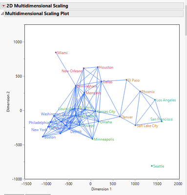

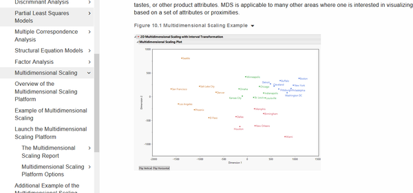

Hallo,
Wie waren die Farben in Multidimensiona Scaling Plot?
nach dem Beispiel des Links
https: //www.jmp.com/support/help/en/15.1/? os = win & source = application & utm_source = helpmenu & utm_medium = a ...
eingestellt?
Danke für Ihre Hilfe.

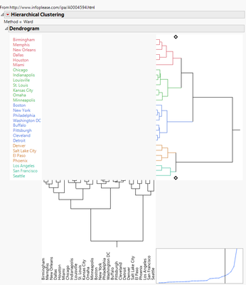

There are multiple ways to do this:
1) Row > Color or Mark by Column
2) Column Menu > Color Properties > Value Color
3) Plot Menu > Row Legend..
Now, it you are asking about how to set the groups of color, I suspect that it was set using Clustering approach
Thierry R. Sornasse
gzmorgan0
Super User (Alumni)
Re: Multidimensional Scaling Plot
@Mi ,
The Flight Distances.jmp data table has a table script named Hierarchical Cluster. If you run that script and select the options: Color Clusters and Number Of Clusters which will initiate a dialog. Set the number to 5.  The 5 clusters will match the color groups displayed in the .PNG and link in your post.
@Thierry_S was correct, this post just adds details.
Mi
Mi
Level III
Hello,
that's how it worked!
Unfortunately I don't get a heatmap for Cluster,
even though I activated two-way clustering.
Why does this not appear?
Thanks for your help.
gzmorgan0
Super User (Alumni)
I was able to get a heat map. I set Number of Clusters to 5 first, then requested Two Way Clustering. ??

Hello,
How can I remove the lines in the Multidimensional Scaling Plot?
Thanks.
Mi
Mi
Level III
Hello,
thank you very much for the really very quick answer.
It worked!
The problem was that I, at least I think so, under
"file, Prefenrences, Hierarchical Cluster, Two Way Clustering
Then via Analyze, Clustering, Hierarchical
Cluster I clicked "Two Way Clustering" again.
Thanks for the help!
