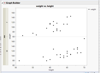

Move "Group Y" to the left side of the graph plot in Graph Builder
Is there a way I can move the "Group Y" in Graph builder so it is on the left side of my graph, rather than the right side (default location)?

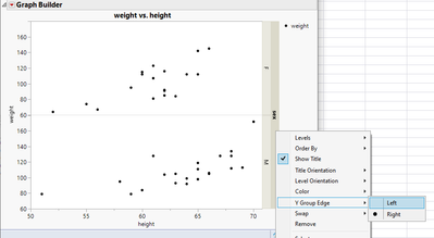

jthi
Re: Move "Group Y" to the left side of the graph plot in Graph Builder
Right click on grouping and from Y Group Edge you can change grouping side
-Jarmo

Raybob
Level II
 @jthi Thank you! I wonder if there is a way to just jsl to move the group y into the graph plot so it's not outside of the plot? I assumed there wasn't a path forward with this, but it doesn't hurt to try!
