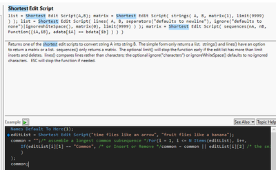

Thank you for extra info! Check out Shortest Edit Script from Scripting index:
With that you might be able to do something, unless it is too slow. Pat Match could also maybe do this, but I haven't (yet) looked into how to use it properly.
editList = Shortest Edit Script(:List of sequences, "FEBRUARY");

jthi
Re: How do I identify words (using formula in column) that have more than 2 characters different from my reference word?
common = "";
For(i = 1, i <= N Items(editList), i++,
	If(editList[i][1] == "Common",
		common = common || editList[i][2]
Length(common) < Length(:List of sequences) - 2;
-Jarmo

Thanks Jthi! Works nicely ;)
