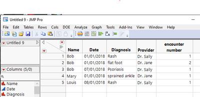

Re: How to find lowest date within set of days for each group
Hi! Thanks for your reply. This works in theory, but in your example you can see that the 1/1/18 visits are 1/2 when they should both be "1" and the 7/1/18 visit isn't "2." Ideally I want a function or column which can tell me if this is the patients first time to the hospital, second time, etc.
Any tips or tricks to get this there?
Thanks,
Liz
txnelson
Try adding the Provider into the Grouping variables for the Col Cumulative Sum() function
Col Cumulative Sum( 1, :Name, :Provider, :Date )
